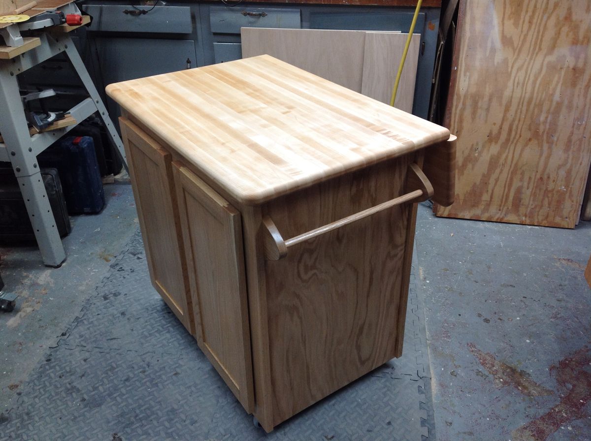

February 14, 20197 yr Author Popular Post comment_178446 On 11/10/2018 at 11:09 PM, Grandpadave52 said: Pictures...we'll need pictures to validate. Well Dave, time for validation! Finally finished the rolling island and learned a couple things along the way! Matt Seller used to say don't be afraid to try something new. I didn't venture too far from the norm but learned a bit about butcher block style tops as well as W/B Poly, two things I had never tried before. Even made my own towel rack dowel. Didn't come out too bad...LOML and capable assistant as well as daughter and SIL are pleased with it and that's all that matters. Maple top (man that stuff is hard...eats screws like crazy even after pilot hole drilling!) and oak carcass. Couple shots attached for Dave's validation request! Gary Report
February 14, 20197 yr comment_178451 Awesome!! Love that towel rack. Something I added to ours was a “surge strip” on the back. Makes for easier electrical appliance use. Report
February 14, 20197 yr comment_178452 59 minutes ago, Gary Hanscom said: Maple top (man that stuff is hard...eats screws like crazy even after pilot hole drilling!) and oak carcass. Gary Hello Gary Next time, try rubbing the screws along a block of paraffin wax to lube the threads. That reduces friction and usually stops breakage in hard woods. hat Report
February 14, 20197 yr comment_178459 Gary that is a great look you got going. Did you have any problems with the glueup on the top? Report
