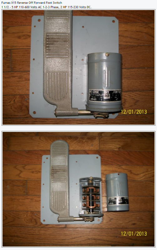

October 26, 20188 yr comment_164068 Nothing that exotic/expensive. All of my machines are belt drive. The motor mounts to the base of the drill press. From there a belt will supply power to a line-shaft/pulley arraignment. The other machines will be ran from the line-shaft/pulleys. It's just a matter of slipping belts on/off the pulleys. The foot switch I'll be using has forward/reverse. The reverse feature will be used mainly for the drill press, and lathe. The main reason for using the foot switch is so that I can move it to the machine I'm using at the time. Report
October 27, 20188 yr Popular Post comment_164240 If anyone was wondering what a foot operated forward/reverse switch looks like, here you go. I have no idea what it was originally used for, but when I saw it well you know how that goes. Report

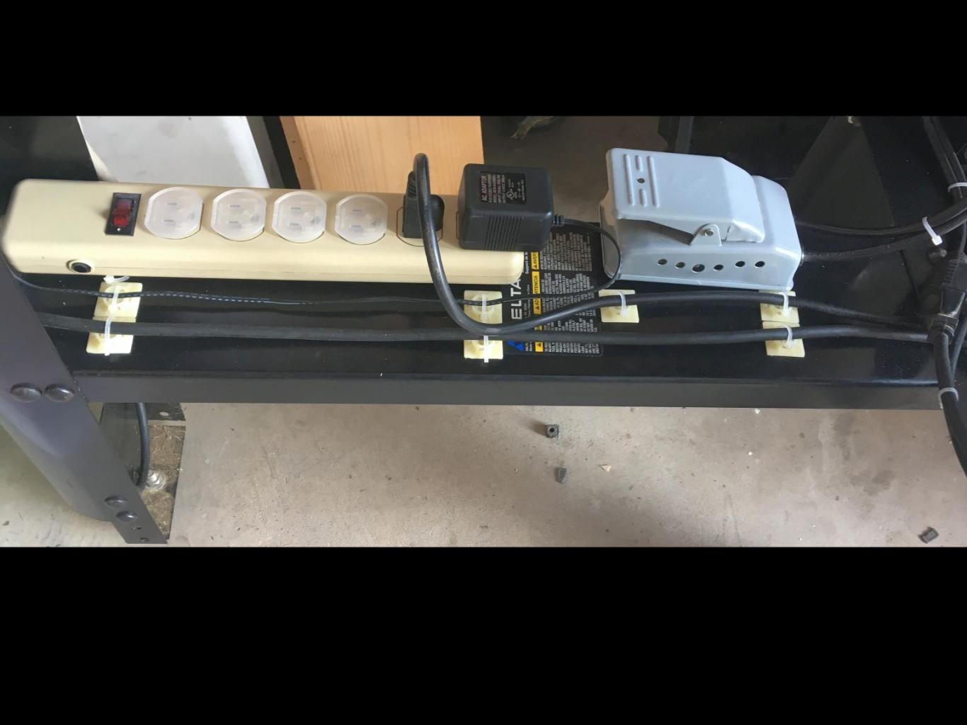

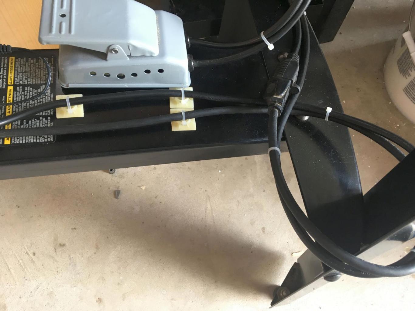

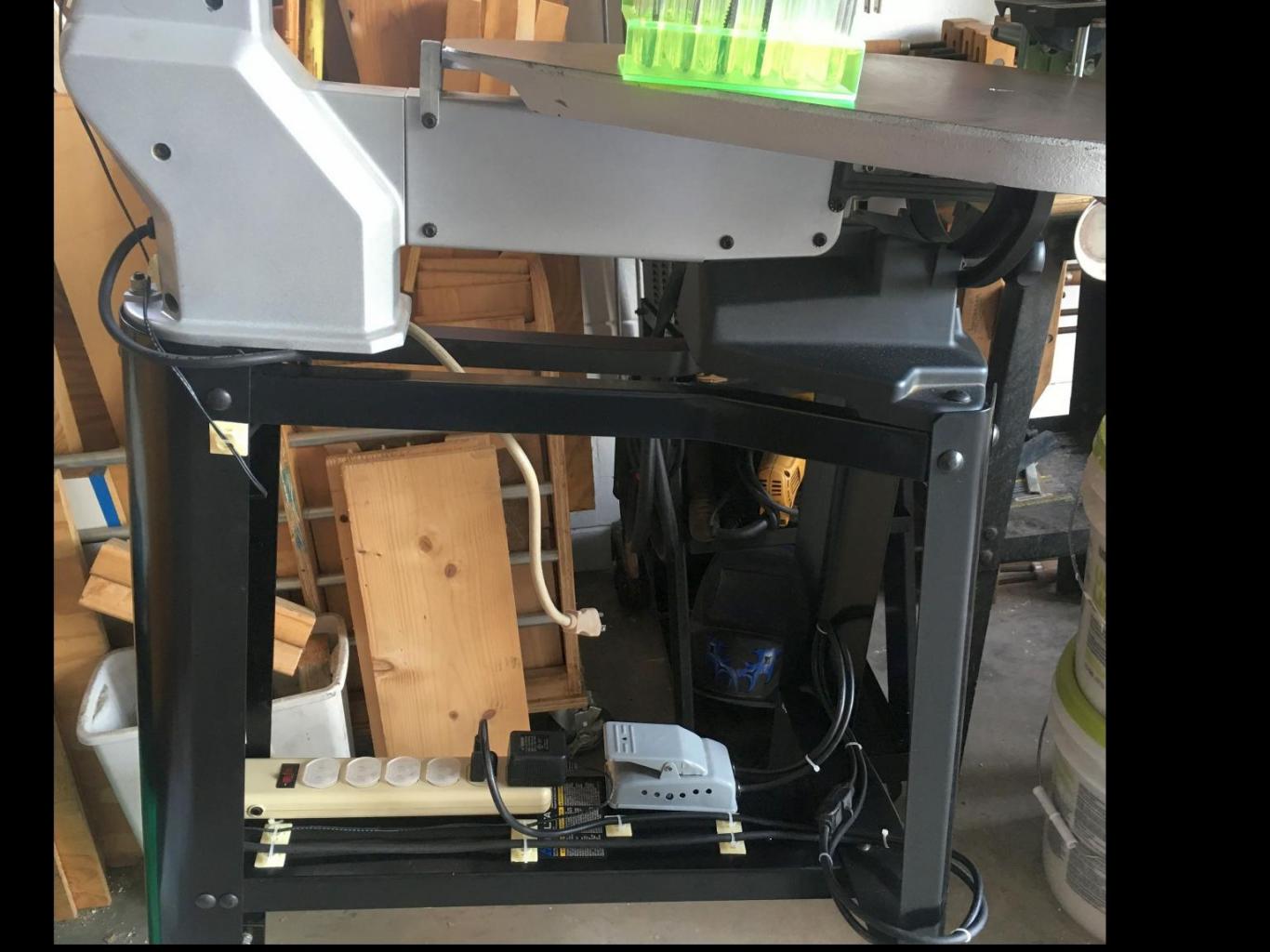

December 29, 20187 yr Popular Post comment_171817 Sorry, I'm late to the discussion...for what it is worth. This is what I did with mine. I got tired of cords hanging everywhere and always being in the way, so I added a multi-strip, plugged in my LED light magnifier, then the foot switch. The other outlets allow for anything else like a corded drill, 1/4 sheet palm sander, etc. I'm not thrilled with the foot switch, but it works very well. I leave the saw ON, with the speed dialed all the way up and control everything from the pedal. The cord is long enough that I can place it on the floor or on the stand brace if I sit on a high bar stool. Hope this helps and/or gives someone some ideas for their saws. Sorry for the contrast...it's hard to photograph a black cord against a black background. Report
December 29, 20187 yr comment_171835 On 10/26/2018 at 10:54 AM, Smallpatch said: I started out using a foot switch on the scroll saw when I bought it is 99 but I switched it over to the drill press after a few months or less and its better there.. The switch on the Dewalt is very close anyway and with me moving around a lot changing blades getting in and out of my chair I could never locate the switch on the floor... I also think if a person uses the stand Dewalt offers he ain't gonna develop into a scroll saw user..especially if he stands all day long as it will make the day longer! The arm hold up attachment is more better and will save time! And Dan you can build one of them if u are using a Dewalt... I have my Delta on the stand. The back leg is adjusted higher than the two front legs This tilts the table down and makes it much easier to see. I sit on a bar stool height seat and it is very comfortable. Sometimes I do stand, but usually I sit...switching and moving around is better for you anyway. The rheostat pedal can be used on the floor, or if I'm sitting down I can place it on the cross brace for the stand. Options are always a good thing. With the table tilted down it is much easier to see the lines and the blade. What you can't see in the first photo above is the LED light with the magnifier on the goose neck. Although, I'm thinking of getting one of the bigger magnifying lights and separate it from the saw. There is just a little too much vibration and the small mag. lens jumps around a little excessively for my preference. Report
