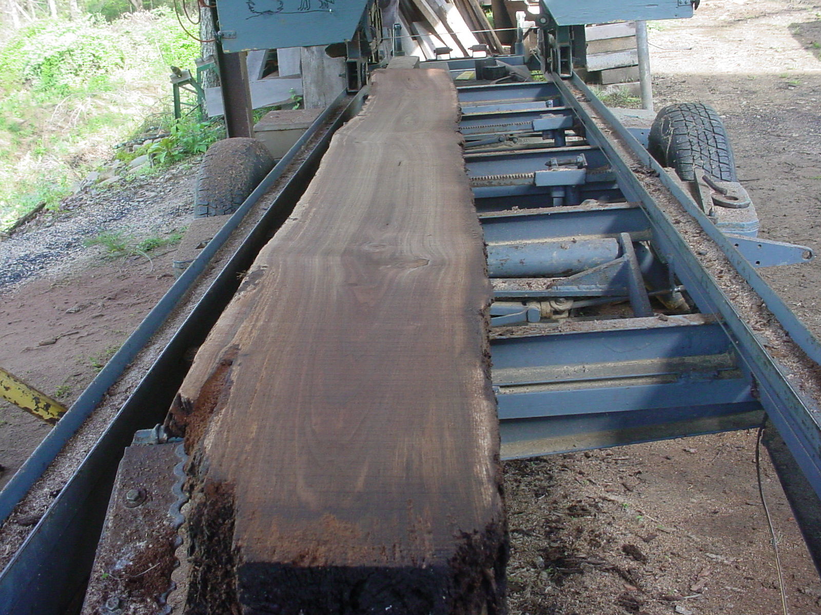

October 11, 20188 yr comment_162297 14 hours ago, Gerald said: Air dried walnut has multiple colors of which you will even see grays and blues. Two weeks ago, while picking up some hemlock boards for my son's house, I got a demonstration of an 'Alaskan mill' He took a 2 1/2" slab off an 8' walnut log about 30" wide. That log had the most beautiful PURPLE color I have ever seen on walnut! John Report
