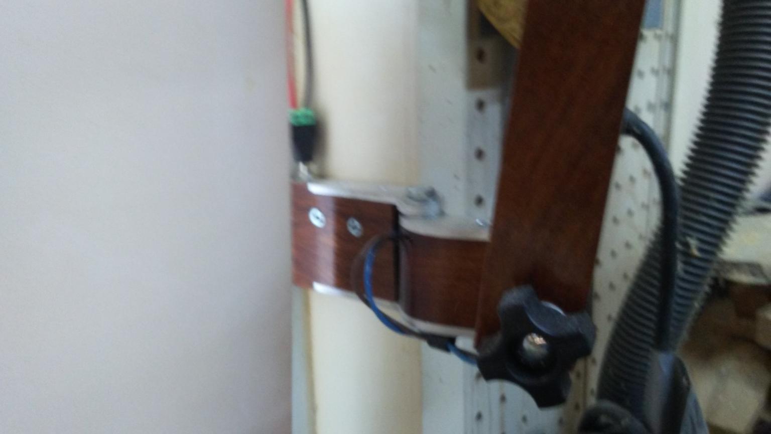

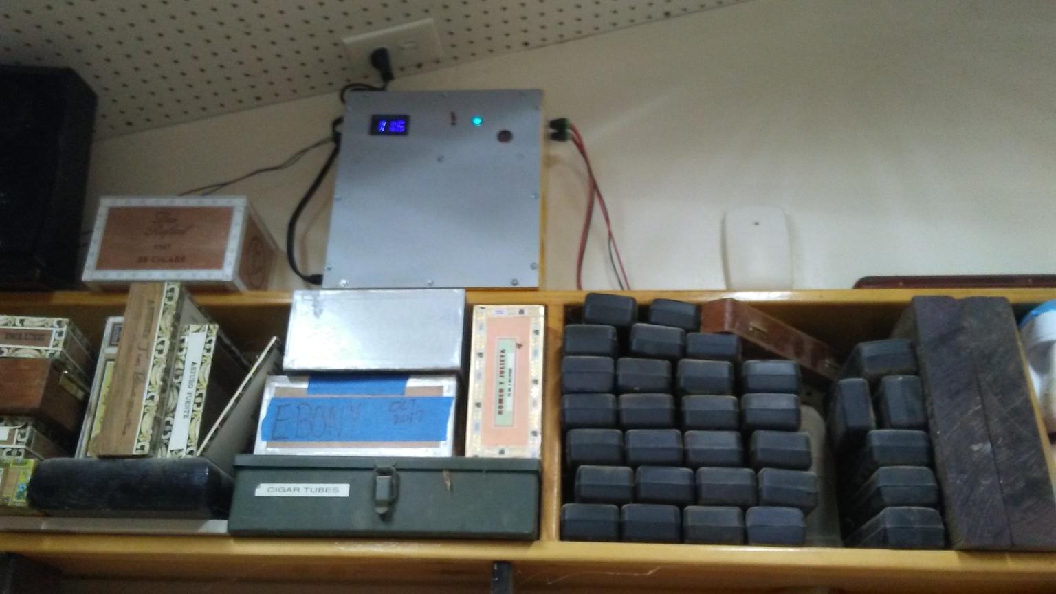

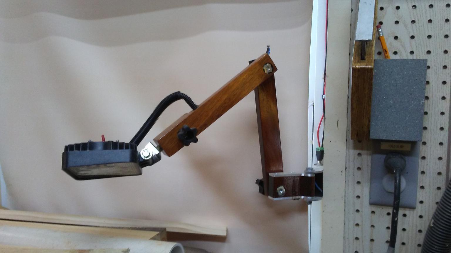

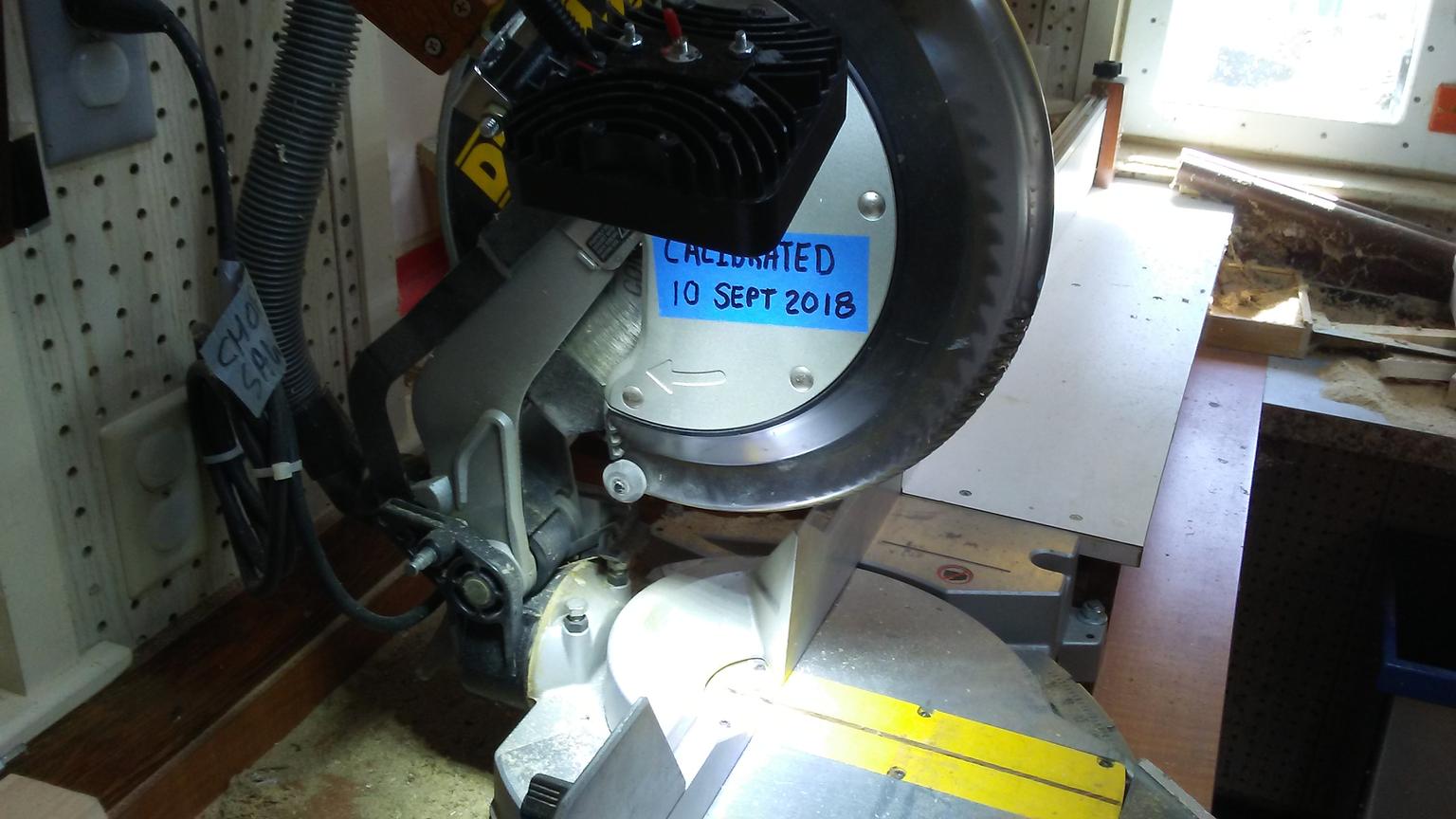

October 3, 20188 yr Popular Post comment_161484 Reality check, none of us are getting any younger. Where we once could see in the dark we now drag out a flashlight. Same is true when making cuts. You want to see the line, clearly. Okay see it at all some days. Task lamps are easy enough to buy but rarely fit where we want them. So enter 12 volt fog lamps. 30 watts of very bright light in a small package that is meant to survive outside and mounted on a bumper being bounced around in the outback. Or Georgia roads, take your pick. The lamp arms are 9 ½ inches long. Inside each arm a channel was made to accept the wiring. While I was unable to hide all the wiring, most of it is and that means less to get stuck or grabbed by something. The arcs of the swing portion were cut offs from aluminum seat pieces my Dad gave me, I believe from a 737. These fit nicely and give it a tad bit more swing back into the window when not in use. 12 volt power is supplied by a power source I build some time ago. I currently have 3 in use in the shop for other task lamps or LED strip lights I installed. The lamps do not come with a on off switch. For this I used a car alarm valet switche and grafted the wires into place then put covering over them. Had too be creative and make a small switchblade then JB weld in two studs for mounting. Perhaps not pretty but for this application it works well. Enjoy and be inspired. Report
