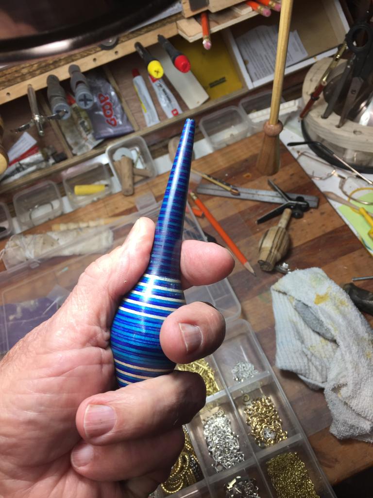

September 21, 20188 yr comment_160462 I don't know if this belongs here but it is about turning. I am finishing a piece (colored ply) and it has tiny tare out holes. What finish would you use to fill them? (or tiny cracks) I normally use HUT friction finish. Thanks Report

September 21, 20188 yr Author comment_160497 I chose to cut cross grain to achieve the look I wanted with colored ply & with sharp tools. The tiny holes are not serious, however I'd like them to be filled. I know that if I apply multiple coats of finish, it will be smooth and invisible as I want. I just wanted to know what finish works best with the fewest applications. The question is "What finish would you use to fill them?" Report
September 21, 20188 yr comment_160502 How about CA in the holes, then finish with your finish of choice. Report
September 21, 20188 yr comment_160544 Gene beat me to it. Since your are clearcoating it will not even show Report
January 2, 20206 yr comment_214269 In the holes that I need filled I use Walnut sanding dust and glue. I have coffee cans full of different kinds is sanding dust from different woods just for this. Report
