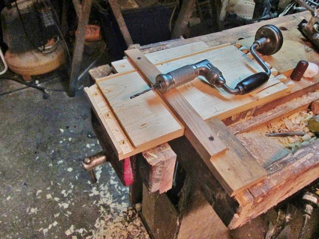

August 29, 20188 yr comment_158277 Hmmm... Maybe more about the drill being used? Have a second such drill, to do the pilot holes.... Report
August 29, 20188 yr comment_158280 You might be on to something ,Steven, I am going to experiment with the speed that I drill the countersink. Maybe slower is better? The fact that it needs a hole first is not a big deal, for bench work 2 drill motors can be set up, one with the drill and one with the counter sink. I prefer to drill at least a pilot hole first anyway, a countersink without one can wander off center easily. When I was a kid working at Boeing, we had those countersinks that could be set for depth and plunged to cut and spring returned. They worked good for metal, not sure how they might work for wood. Like these: https://www.browntool.com/Listview/tabid/344/CategoryID/62/Level/a/ProductID/223/Default.aspx Herb Report

August 29, 20188 yr comment_158289 2 hours ago, Dadio said: You might be on to something ,Steven, I am going to experiment with the speed that I drill the countersink. Maybe slower is better? The fact that it needs a hole first is not a big deal, for bench work 2 drill motors can be set up, one with the drill and one with the counter sink. I prefer to drill at least a pilot hole first anyway, a countersink without one can wander off center easily. When I was a kid working at Boeing, we had those countersinks that could be set for depth and plunged to cut and spring returned. They worked good for metal, not sure how they might work for wood. Like these: https://www.browntool.com/Listview/tabid/344/CategoryID/62/Level/a/ProductID/223/Default.aspx Herb Might try drilling the pilot holes from the "inside" of the board.....then allow the countersink to also clean up where the bit came out... Report
