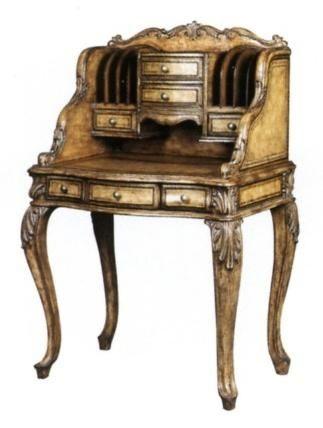

July 9, 20188 yr Author comment_153562 Cal thanks for bringing that up!!!! Don't know how this will play out with the legs and table... Hopefully I will carry through with my thoughts at the sale for I could visualize great things I could do with those legs. I have had this picture for some time now and have been wanting to build this desk, maybe a little wider but with legs like that.....but for a guy who don't have a cnc that can do 3D just getting two legs to match is a chore. Oh I could cop out and refinish the table and put a slab of something on top but the desk would accomplish more of my want.....I have been thinking with the legs probably three weeks would be removed off the time spent making the desk. I have no measurements on the desk so each step would be the same as a tea pot I think this was the reason I laid the legs on top of the table saw so I would continue on those thoughts....More than likely after all the yard season is gone for the yard was partly the reason the motor home has not been on a trip for quite a while now.. Oh it stays plugged in all the time and I can hear it trying to crank up by its self. But hey, I'm smart so I leave the keys in the house... Edited July 9, 20188 yr by Smallpatch Report

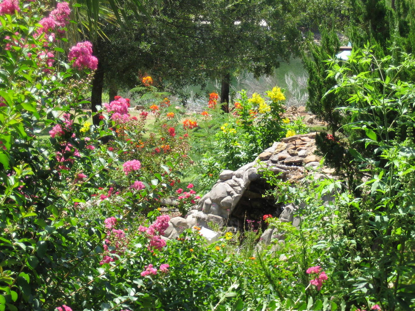

July 10, 20188 yr comment_153642 Now that is a desk I would love to see the build along with. Go for it Jess! The yard & flowers look beautiful, but not sure about the pile of rubble in the center? Is that a domed doghouse, the entrance to your cold war fallout shelter or what? Report
July 10, 20188 yr comment_153646 2 minutes ago, Cal said: Is that a domed doghouse, the entrance to your cold war fallout shelter or what? Sweat lodge? John Report

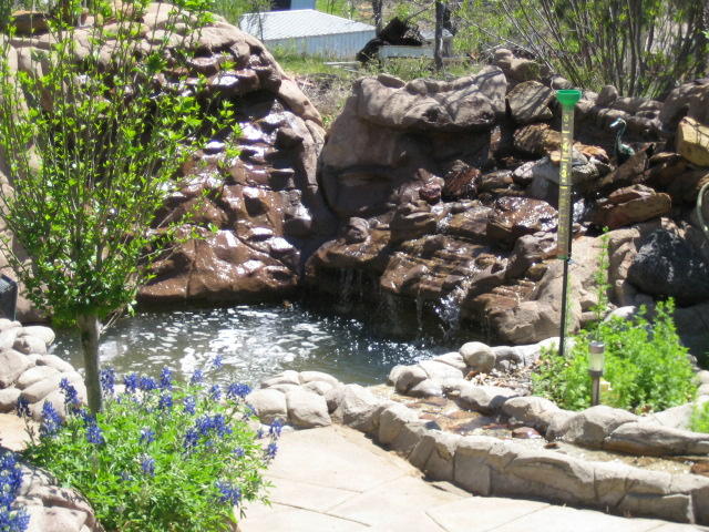

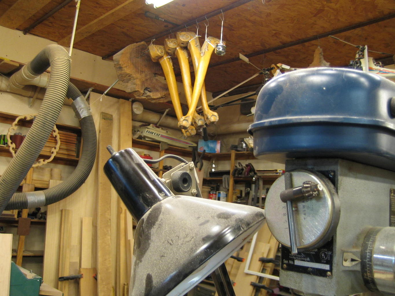

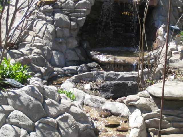

July 12, 20188 yr Author Popular Post comment_153820 I think I will name this the Patriot Woodworker obs tickle course.. I hope I didn't do the wrong thing in hanging these legs up out of the way...They are there to remind me of something. Cal that was the start of the river from the wrong angle. As I was stacking up concrete to become rocks I was going after as much sound as I could get out of a short waterfall..So instead of putting the catch pond out away from the falls, I built a cave type pond inside so it would act as a echo chamber and it saved space.The other picture was a top side view. And this is the end. I use a swimming pool pump and sand filter and it is located inside the tallest falls behind this pond. My original thought was to install an over head sun screen over all of this like Lowes uses in their garden center for the Texas sun and have passion vines growing all over the supports... And yes the pump house is all concrete including the heavy door so it could be a tornado shelter.. 99% of the rocks is concrete. There are a few real rocks but they are the ones just laying around somewhere. Report
July 12, 20188 yr comment_153829 1 hour ago, Smallpatch said: They are there to remind me of something. Would it be that screwdriver you left stuck just above them? Report
July 12, 20188 yr comment_153832 Guess I will have to make sure the wife does not see this. Must have taken a while to build all that. Looks cosey . Report
July 12, 20188 yr Author comment_153841 Dave you caught me....I don't do things like every day normal people....I'm actually out of arrows and since I don't know how to use this little phone that my wife plugged in and laid on my desk about 15 years ago I can't just pick up the phone and order more arrows so I did the next best thing... I reinvented my bow to shoot screw drivers.... Being an Ex-Mac Tool person I happen to have lots of wood handle screw drivers laying around doing nothing.... And since I am still working on the mechanism to set the sights I find my screw drivers all over the place. The one you asked about didn't cause much problems like the one real close by for it went right through the helicopters gas tank. Sure glad it has been 25 years since I have flown those toys for there was not one drop of high octange fuel to explode. So if you don't mind why don't you go back and start mowing the yard again instead of making your wife doing it on the pretense of having a hang nail or something. I just learned something the last couple of weeks.... We have chiggers...... Always had chiggers!! But someone suggested try coating your legs with Johnson's baby oil and see what happens.. And to keep mosquitoes away, rub Johnson's on your face and arms and upper body... and for best results do that before you put your shirt on, I'm talking to you Dave!!! Report
July 12, 20188 yr Author comment_153846 Gerald, our land slopes bad toward the lake...I built lots of terraces with rebar and concrete. Had to order much dirt to fill them up when I started all this the next week after buying this vacant land. No plans ever but I did for see this type of stuff all the way to the waters edge.......A knee replacement and the doctor saying you won't ever be where you can get down on your knees and work again ever....so the crawling around welding rebar up and tying stucco wire to it for the forms for the concrete just about came to a halt...... This week I finally attached the base boards in the bathroom from the remodel back in 2010 and that doctor was right, for I still can not crawl around the floor like a person should do in those situations... Report

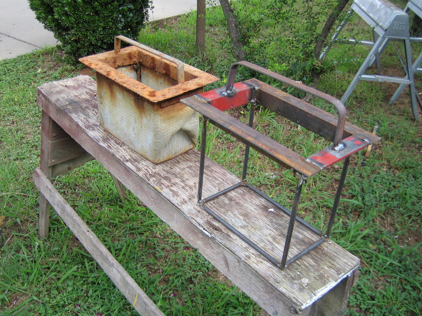

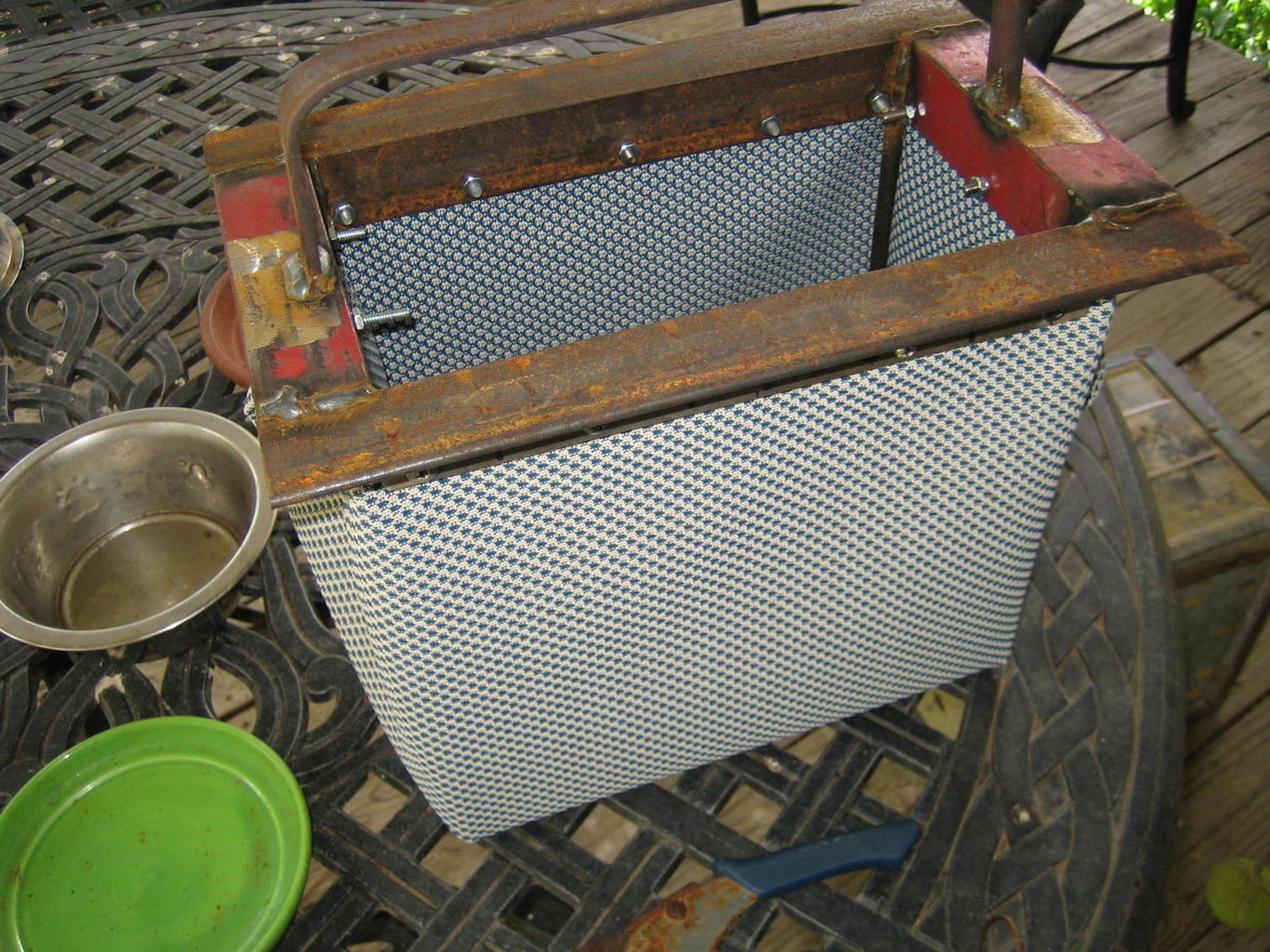

July 16, 20188 yr Author comment_154342 For any pool or pond you need a way to filter the water or else it will get rancid in a short time.. While I was putting forms up I made a list of things I have to do to make things work good, like how will I drain the pond and how will I filter the water. It will have to have a filler pipe and a float to shut the water off and to keep the water at the same height all the time. Don't need an automatic chemical set up just the ole hand full is good enough here.. I couldn't find anything store bought so I formed up a square box of concrete connected to the outside with one side of the pond about a foot wide and three inches lower so the water could flow in and out at the bottom of the tank through pvc to a swimming pool pump with a hair strainer attached before the water goes in to the pump..I built the one on the left in 2000 .. The filtering material is what Lowes has over their garden area and it last about 9 years for it has been changed twice and was just now getting small holes in a place or two... The frame is rusting bad so the reason for a new frame. The one I just now built will have more area to trap more junk. I am trying a better filtering material I bought about 30 years ago at an auction. Its nylon like the Lowes stuff but a tighter weave. This is upholstery material for outdoor furniture.. My advise, don't even think of building a fancy fish pond with those colorful fish with out including a filtering system even if your neighbors are a long ways off, they will be knocking on your door about the odors...We learned that lesson at the go-cart, mini golf attraction.... I do back wash once a day and clean this catch all trap every other day which consist of more or less just turning it upside down then hosing it down from the outside in .. Maybe someone still having a day job might not want to fool with ponds and waterfalls and things but being retired one does need something to....And people do like the sound of waterfalls.. Report
