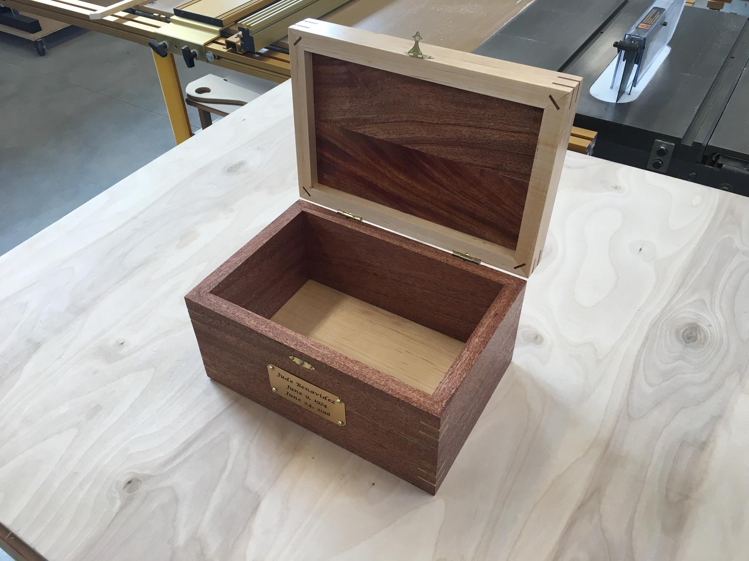

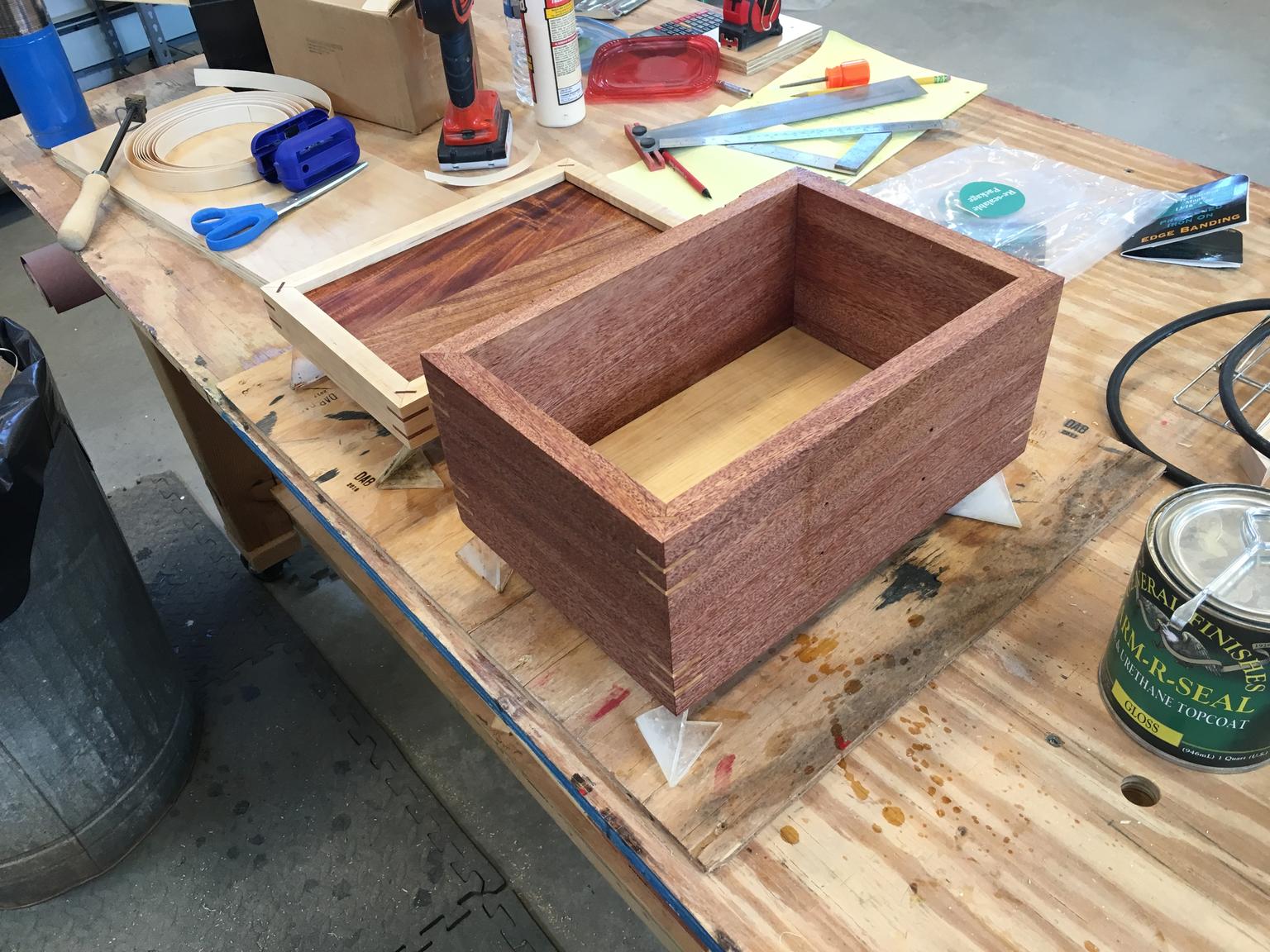

first coat of finish on.
small holes on front are for screws for a nameplate.
Edited by DAB

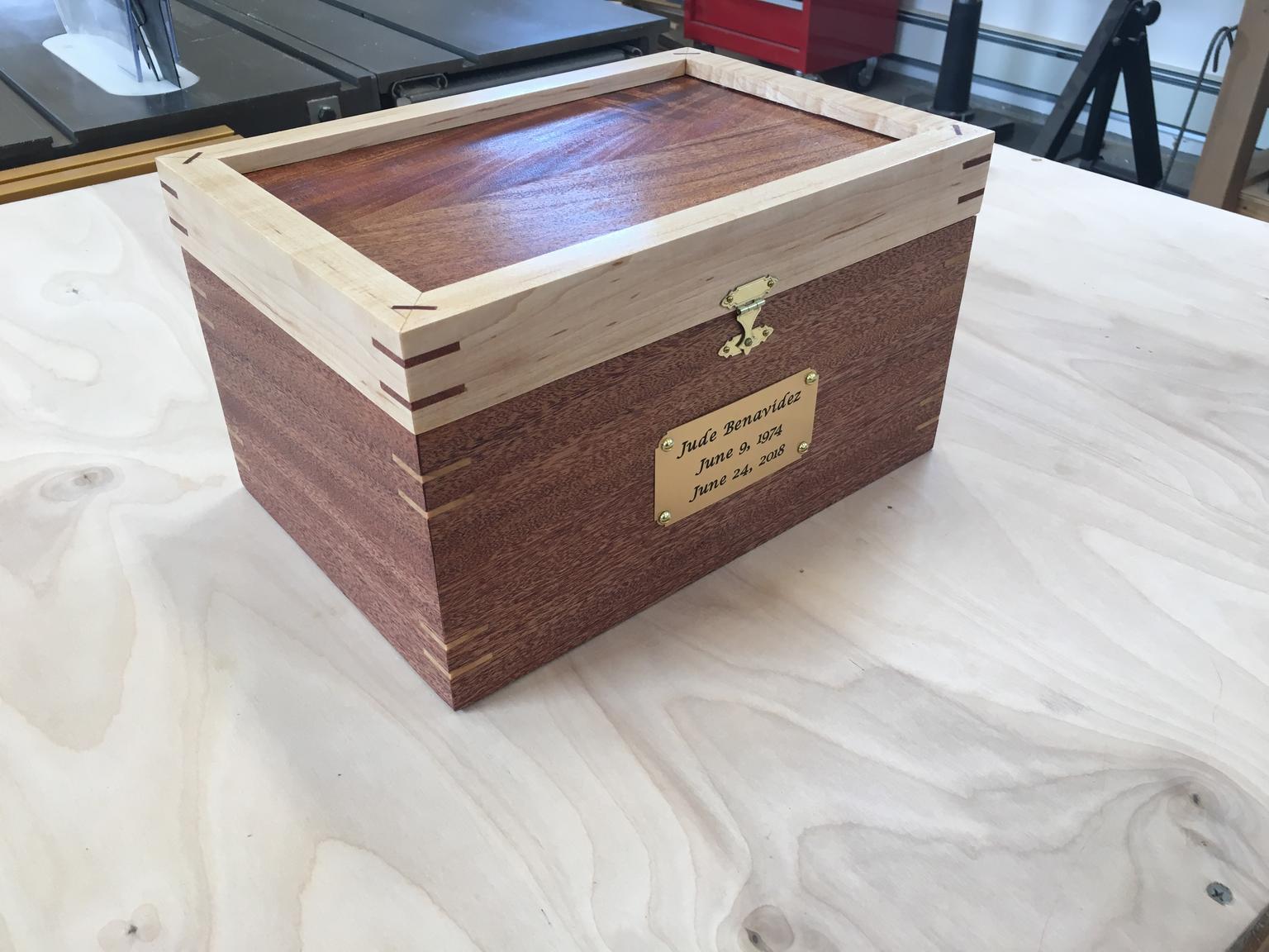

second coat of finish on this AM, it's looking really good.  pics when all done wednesday.
done.
Five Stars DAB. Craftsmanship extraordinaire!
Considering the circumstances and intended use, the recipients should be well pleased & quite proud they chose you for this work.
Thanks for taking us along this journey.
you just need a table saw, dado blades, and some patience.  and a spline jig is helpful too (i made mine, but you can buy them too).  only limitation is your imagination.  go forth and do great things.

And I might add, a bit of craftsmanship skill and imagination. Nicely done.
A splendid gift Dab and very evident that you put a lot of thought and love into this one.
What are the overall dimensions of this?
Very nice Dab, the recipient should be very pleased.

Inside 11 x 7 x 4-9/16 for the bottom. Top same, 11/16 under the lid. All 3/4” thick stock.
