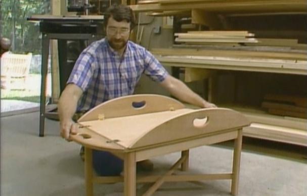

Speaking of Norm, and sorta of what @Gerald said-
These hand holds are comfortable and are created with a jig like you did.
I made a couple of these butler tables. The hinges cost more than the wood. The first table was solid Pennsylvania walnut and was a gift to my brother. They sold it at a yard sale :angry:
