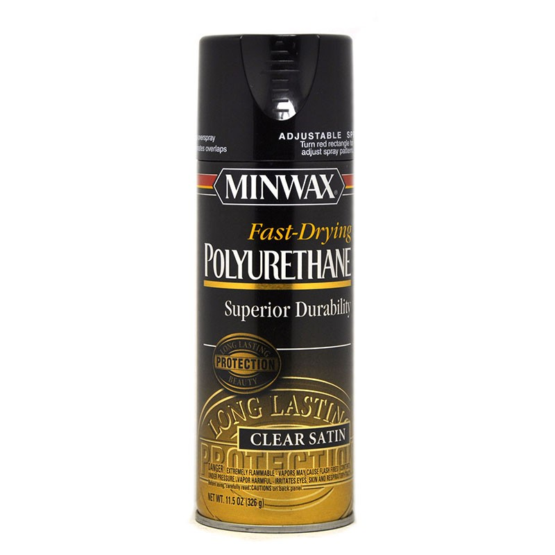

Well if you just wanted to leave it natural looking some wipe on poly or spay on from a "rattle can" like one of these; most also offer wipe/brush on versions of the spray. Since it's going to be in your shop, be sure to apply finish to the bottom of the legs to minimize moisture from wicking up the leg. Hope this helps a little...I'm sure others will chime in and hopefully our site finish guru @kmealy will offer some suggestions too.

Right on Gramps, thanks

I would agree with above comments.  It needs a finish or it's going to get dirty.  Round-over the sharp edges so there is not a single point of contact for bumps and so the finish does not pull away.   Spray or wipe-on seem to work best for things like chairs that have lots of concavities in the intersection of joints.  Shellac or varnish would work fine.

I thought the pieces the go between the legs at the top under the seat were called crossours. What are they called? I think I will get some of that spray shellac that Dadio recommended today and finish it. Thank you guys for all the input!

You will like the spray shellac, sand the nubs with 400g. between coats and it will give a nice finish. After you get used to it try some clear acrylic over it after the second coat. if it is a warm day, I give at least 2 coats a day.
Herb
Right on Dadio, I will give it a try.
