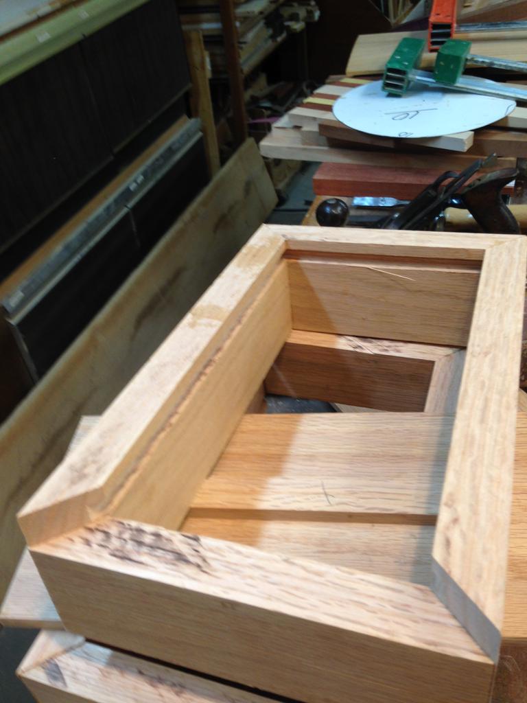

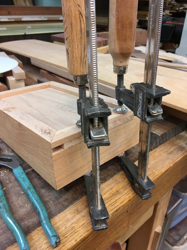

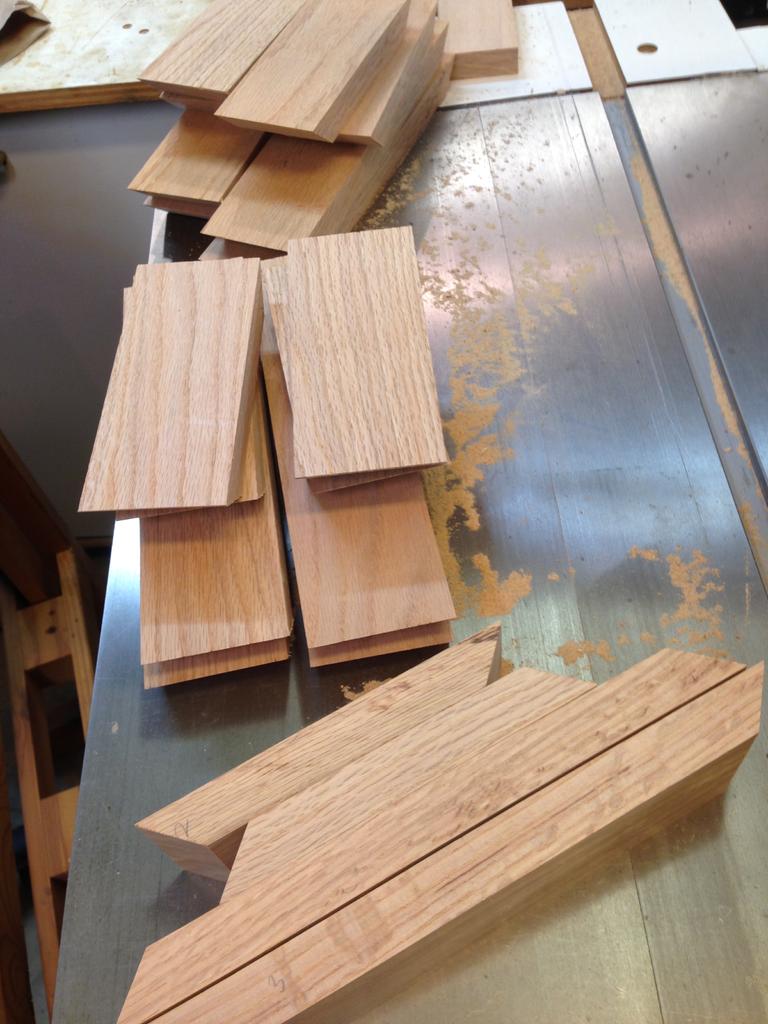

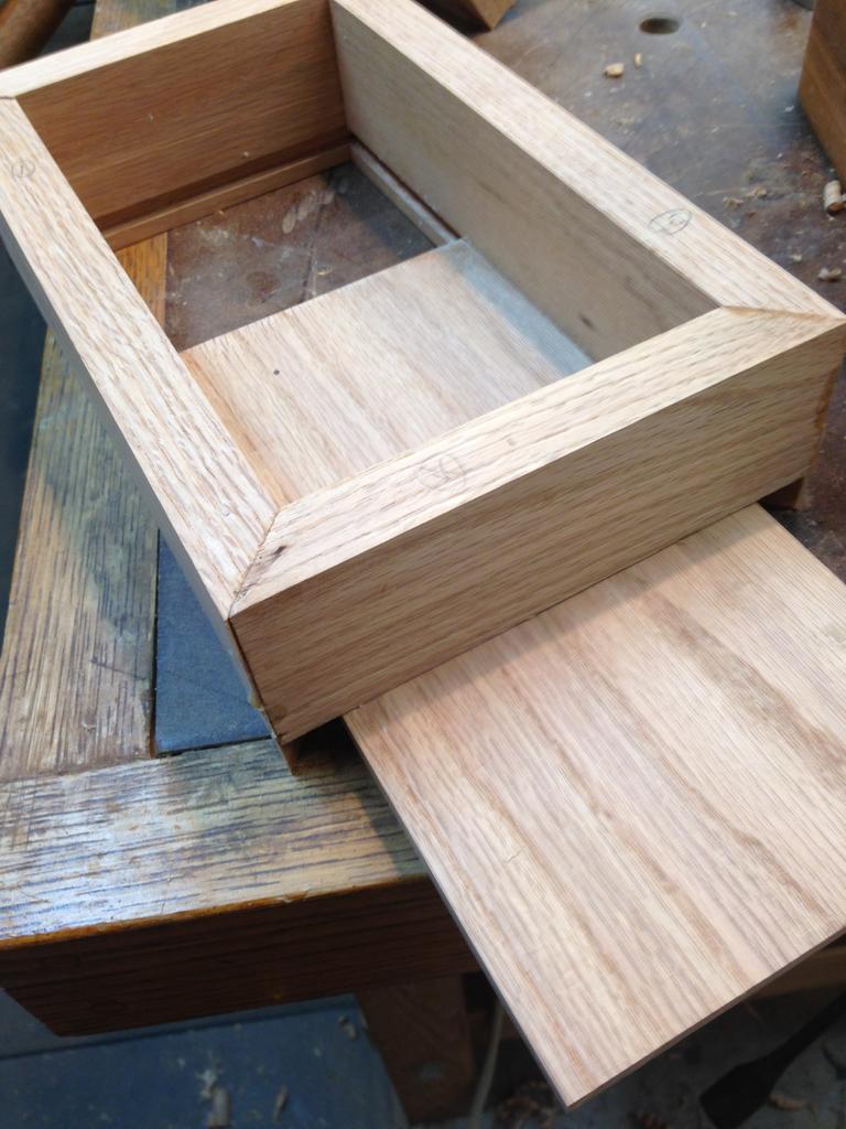

May 21, 20188 yr Popular Post comment_149858 Had a request from facility mgr at church for tissue boxes so they would not get crushed. So this is the beginning PIP. That small piece on the corner is tyo glue on the slide for a handle. view of the bottom dados r e test fit of bottom. After this discovered I had a gap on ends of slide so will have to fill that. More later this week Edited May 21, 20188 yr by Gerald Report

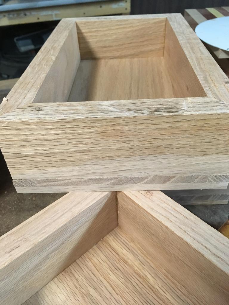

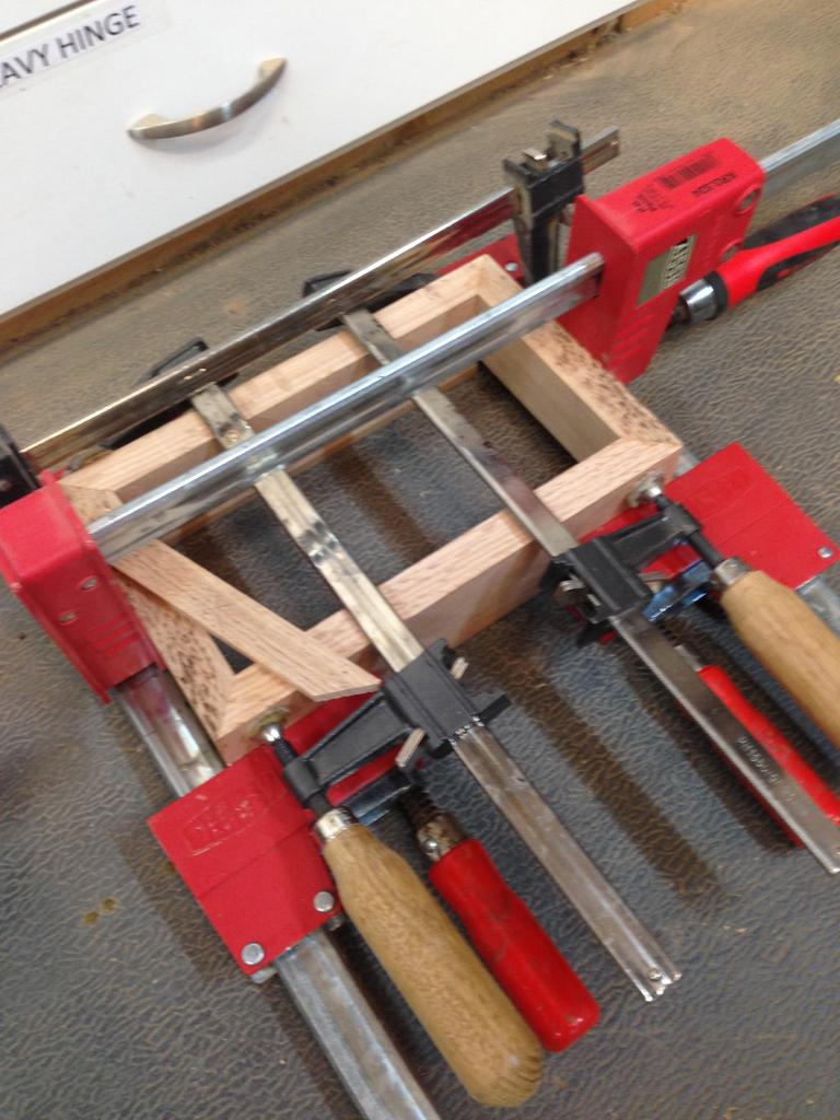

May 23, 20188 yr Author comment_149963 Did more glue up today and put the corner block in the bottom corners. Report

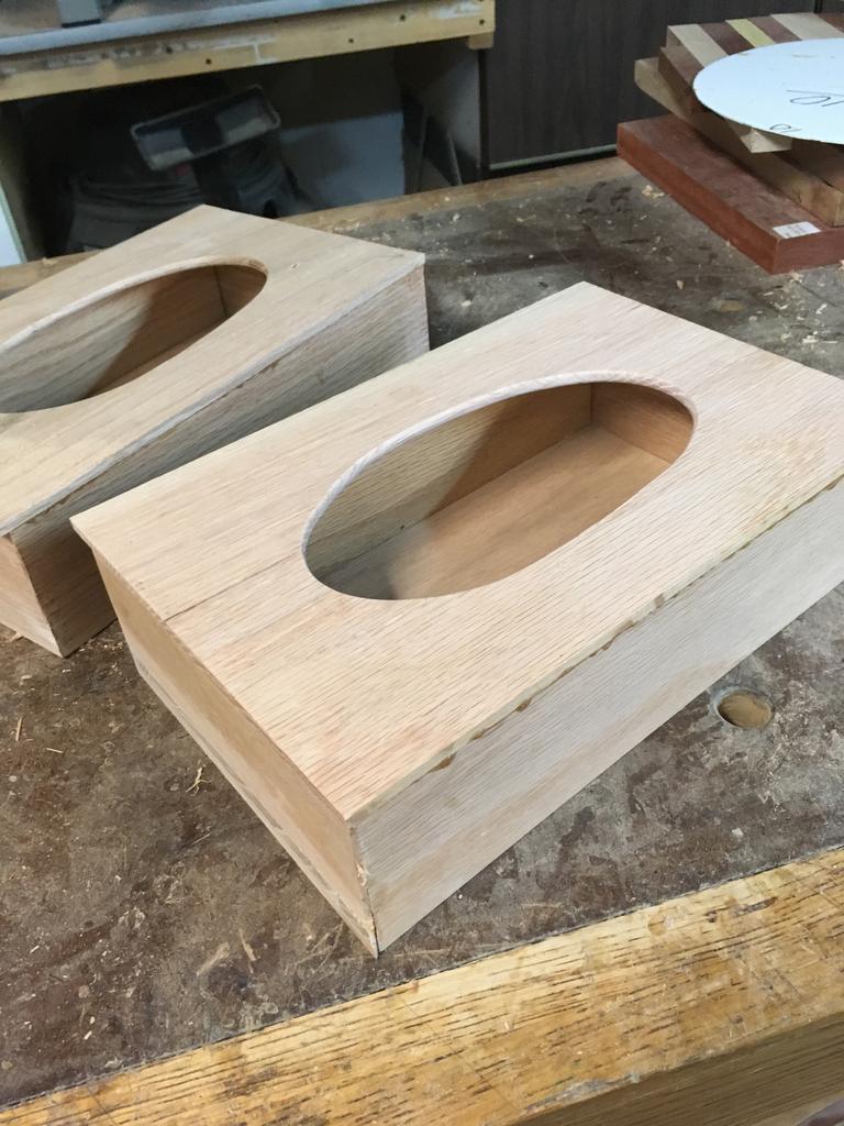

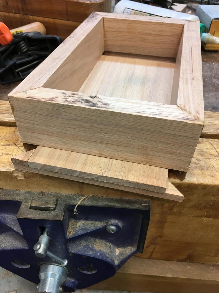

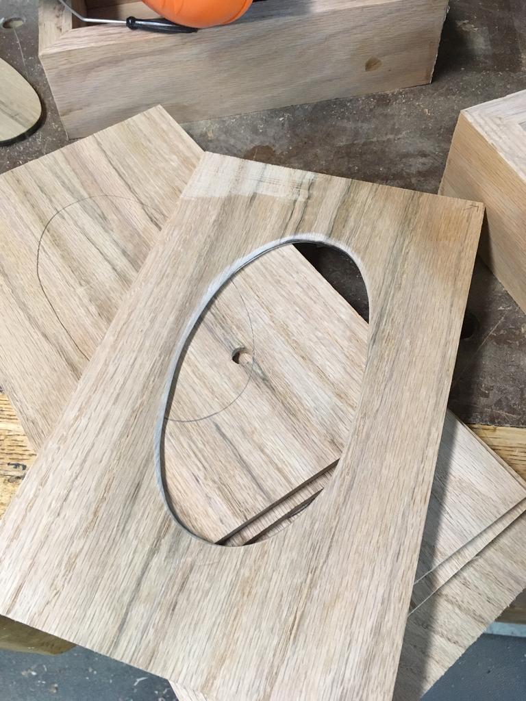

May 26, 20188 yr Author comment_150197 Guess I need to reply to size. I figured that if anyone sat on then since will be on the seat, the extra thickness will survive. This project may pick up next week as I got the product ready to go to DIL studio and my son will be here today . So I got the corner chips glued on the slide and sanded flush. Then started on the cutouts for the tops. Report

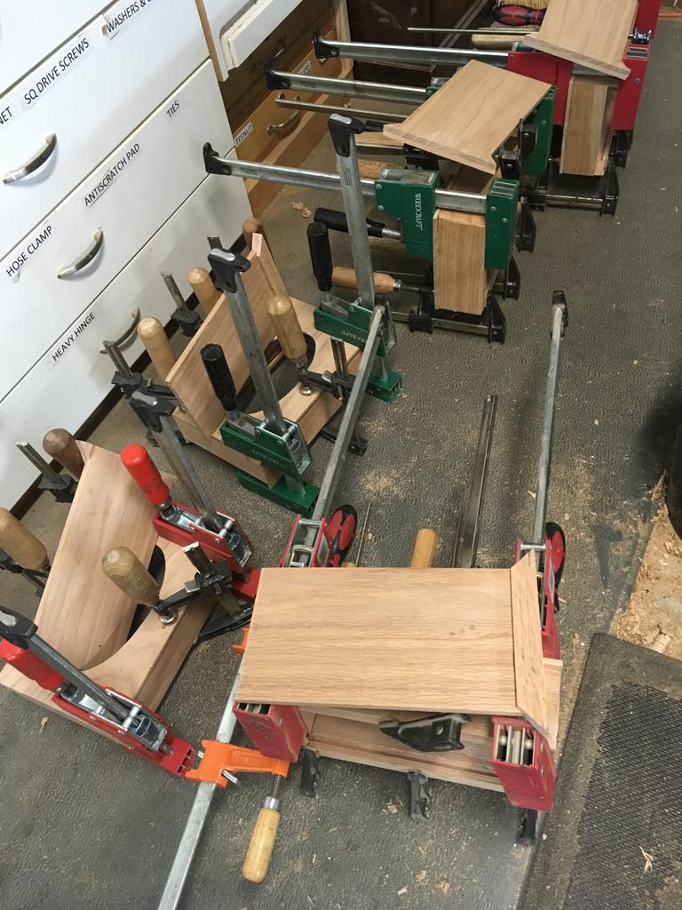

May 27, 20188 yr Author comment_150306 Well yesterday got the tops cut and round over on inside Report

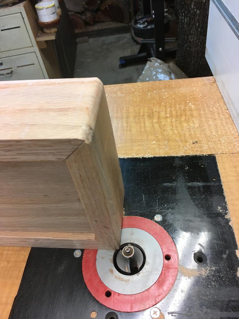

May 28, 20188 yr Author comment_150387 Got some more done after trimming some hedge. Cut down the tops to flush and scrapped the sides w cabinet scraper . Then rounded the corner and did top bead at router table. Report
