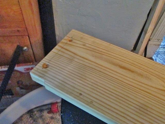

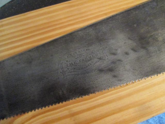

steven newman Posted May 28, 2018 Author Report Posted May 28, 2018 (edited) She already knows how I feel about that ....stuff. Back to wood working, today...an all hand tool day, at that....had to work upstairs in the Dining Room, on the table.....and a large shop stool. Needed 8 holes drilled.. Two on each end of the two side rails..pilot hole was a #6 bit for the lag to fit down into the #13 counter-bore...Cordless drill was used.. Might be a Stanley made one...Top of the rails on each end needed a small notch cut..so the end of the rail will fit the notches in the posts...cross cut was the easy part Which left a long rip cut... Two-handed grip....sitting on the plank, which was sitting on the stool and table...handle was a bit cramped.. For all four notches...Holes were done, so was the notches...needed a rail to sit the slats on...2 x 2 x 8' was a tad long.. Decided to test drive that PM Mitre box and saw.. far end was clamped to the plank...accounts for the weird angle once I got through...Saw will needs sharpened. Then a bead of glue and a few screws...and the only power tool of the day...a cordless hammer drill.. Twice. Let the rails sit, awaiting the "finish"...dragged out the foot board ( trying to hide?) and will see about a coat on all three parts. Boss likes the first coat....guess I will have to "one-coat" the rest...maybe I can get this bed done, by the end of the month? We'll see..stay tuned.. Edited May 28, 2018 by steven newman HARO50 and p_toad 2 Quote

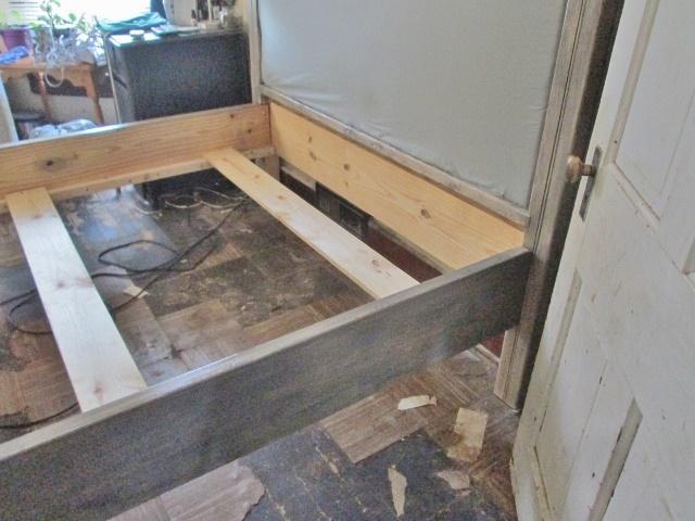

Popular Post steven newman Posted May 30, 2018 Author Popular Post Report Posted May 30, 2018 After messing around most of the day, including a round-trip to Huber heights, OH....finally got the old bed torn down, frame frame went to the curb... needed a bunch of room... Set up the head board.. 1/2" socket on a cordless hammer drill, to drive the lags in tight. then add the other rail...or try to... This end was too tight to fit the notch. Walked down to the shop for a wide chisel....used a 16 oz hammer...NOW it will fit... This end had a twist to it...big c clamp to pull the twist out, lags kept it that way.. cut the slats to fit..with a handsaw.. these two weren't too bad...third onewas a hair tight... Size 11 shoe made it fit..all three were screwed in place.. But no glue....still having to disassemble when moving...3/4" plywood was laid down onto the slats, and a few screws to keep it there.. Took a bit of work, but mattress was installed, with a mattress pad on top, and a fitted sheet Calling this thing DONE! Needs the covers and the pillows...this thing does not even budge...it ain't going nowhere... Almost done with my third Yuengling Traditional Lager....been that kind of day... Thanks for following along... Dadio, HARO50, p_toad and 2 others 4 1 Quote
