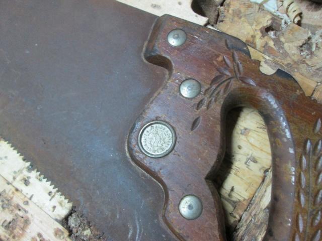

Had an Atkins handsaw, from the auction..wasn't the cleanest one of the bunch..
The big medallion said it was made by Atkins, over in Indy, IN....

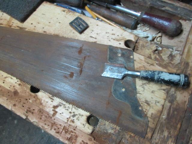

Nickel plating was flaking off a bit, or was worn off...tool to remove these..
These then went to the wire wheel on my grinder, for a quick polishing.   The next step was to remove the handle..

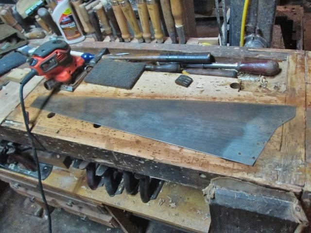

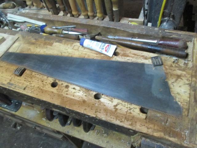

Fresh sand paper on the palm sander, to down down the rough, worn finish...set this aside..
80 grit to hold the scratch pad...meh, came back with some 120 grit.   Got this side fairly cleaned up..flipped the plate over, and tried something new
Didn't work out, too well...scratch pad, then through the 120 grit, and 220 sandpaper..

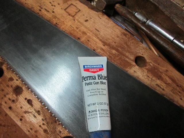

Started seeing the faint remains of the etch...Atkins Perfection No. 59 tried to bring it out better.
Sometimes this works, sometimes not.  Depends on how deep the etch still is.  Coat the surface, let it dry, sand away the high spots, and maybe the etch will show up..

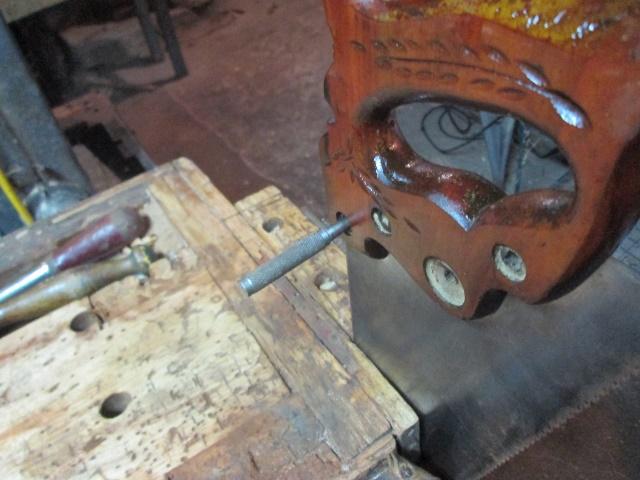

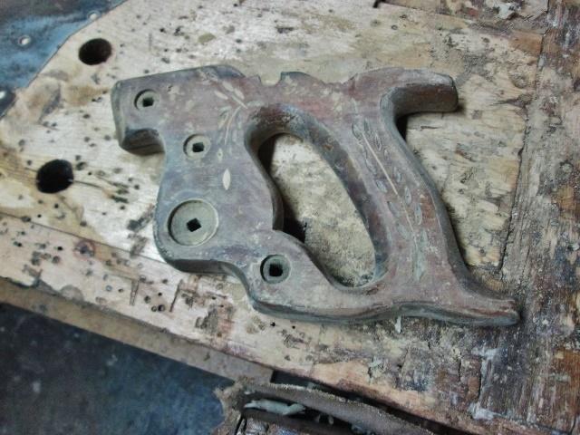

Handle was wiped down, and a coat of shellac brushed on...next, was trying to line up four holes to insert the bolts..
Have a long nail set. I work from the center holes out,
I also "clocked" the slots to the same spot.  Set this saw up on it's edge..

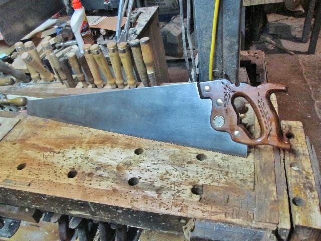

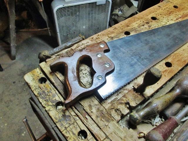

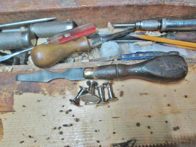

Looks a little better?  Bolts were nickle plated Brass...did a test run..

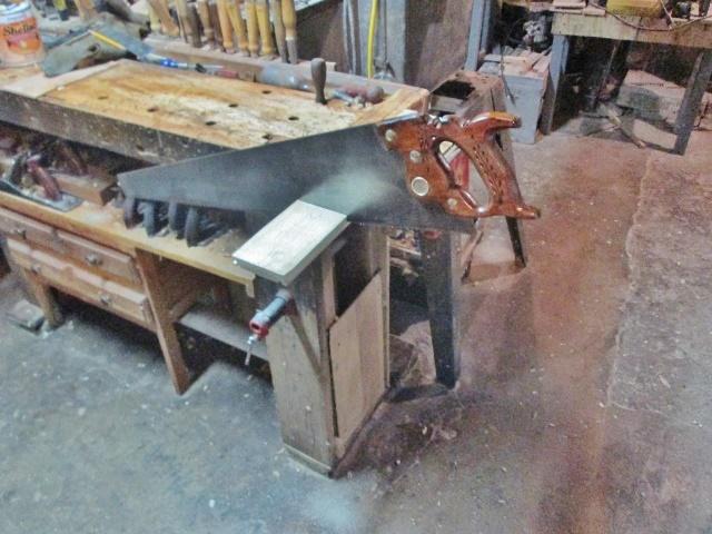

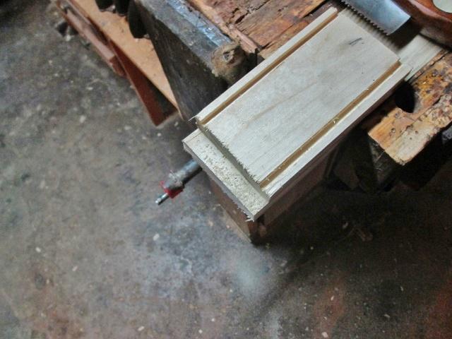

And the results..(allowing for Operator Error, of course)
8 ppi, 26" long, straight backed, crosscut saw.  Might be a keeper? For just over an hours work, did not need sharpened.

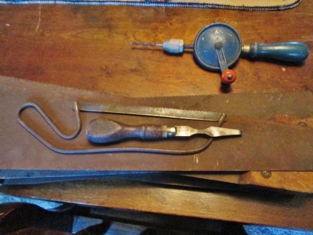

Trying to figure out HOW to rehab another of those saws from the bundle..
Not even sure IF I can get the blade off of that steel handle.   Screwdriver, and that  Stanley No. 1221A drill have been rehabbed, now.
