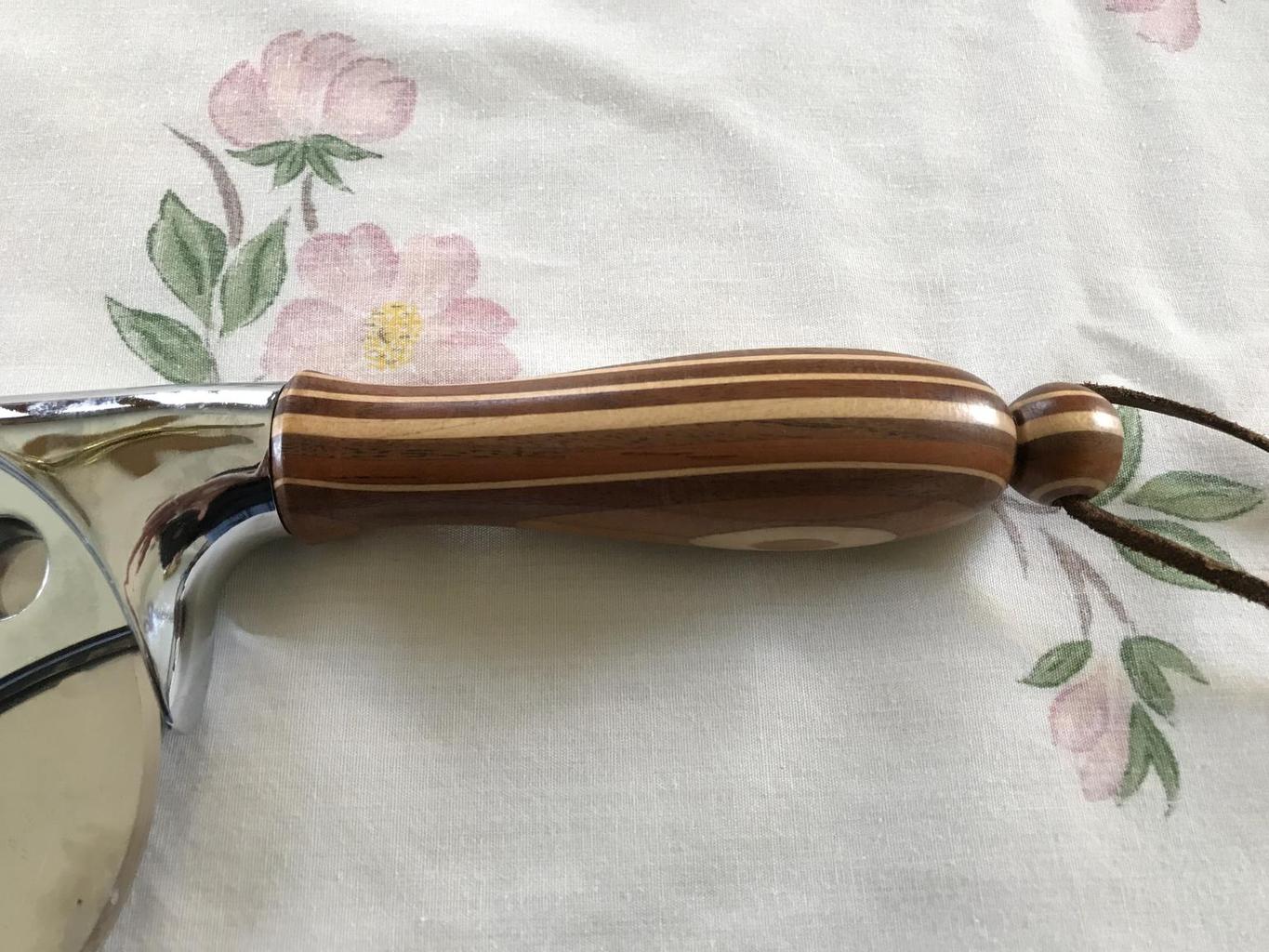

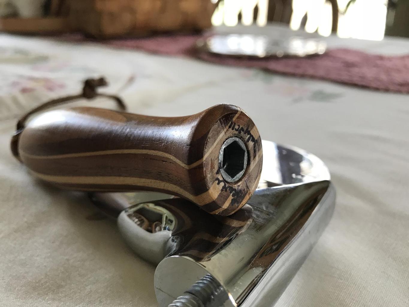

It’s not color ply but similar laminated construction
3E59077C-67C5-4DE7-BBEB-0C46FD4BFA9A.thumb.jpeg.89ee452782b72bd0818851133d25daf0.jpegC7525065-9DD8-4E48-B8C1-7CE12298B002.thumb.jpeg.42f56c33080c3d02a62b85e1d7348f3f.jpeg
instead of gluing/threading into a hole I used a threaded insert. The insert allows the handle to be removed so the utensil can be washed.
when threading the insert, use a small greared hose clamp to keep the laminations from being stressed
That is a great idea Lew. May have to try it
