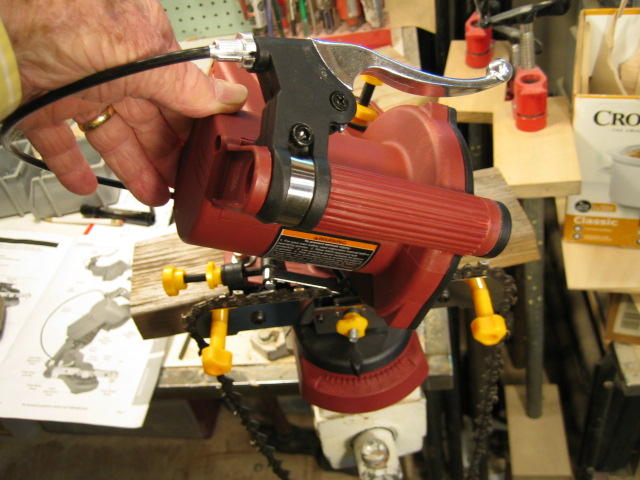

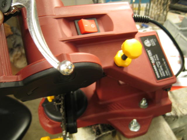

Dave you mentioned a guy on you tube was grinding into the chain in a demo, the little yellow knob on top can be set to keep that from happening.. another reason I don't put much truth in to what I see until I do the testing my self.IMG_0195.JPG.3ef1c121faafa8fad9764643fd5932bb.JPG

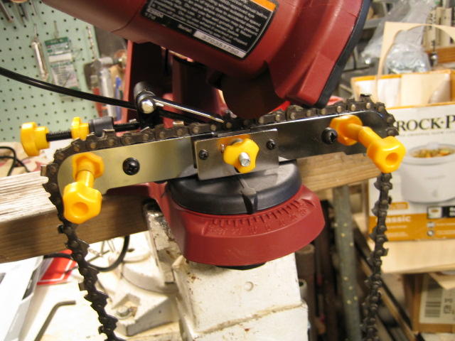

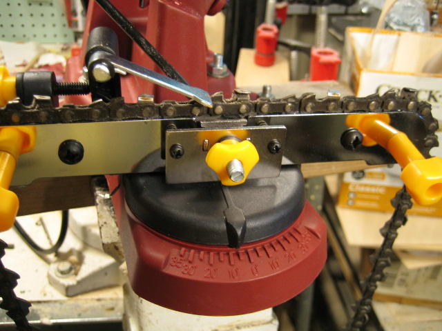

Once you set the angle and the depth and as you are holding the little chrome lever down with just a little pressure then with the right hand squeeze the bicycle brake with you right hand this will lock the chain down so you can swing the blade past the tooth without anything moving, so this action can be repeated over and over  hen when all the right handed teeth are ground, flip the chain over, make sure all is reset and grind away. The little chrome lever can be set to hold the right distance on chooses while the bicycle clamp is engaged... Even though the parts to be secured are partly plastic nothing should move out of place when the blade is swung past the teeth.
  Everything thats needs to be set can be secured enough to make continuous grinds.
