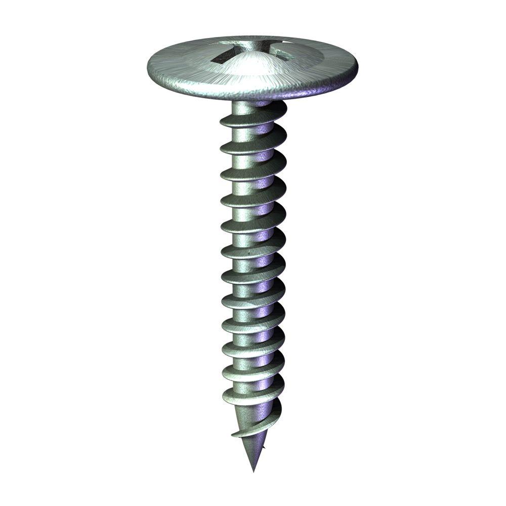

use truss headed screws... 7/16'' seems to be the length that works the most often...
