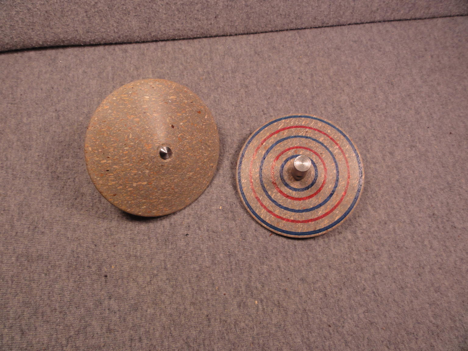

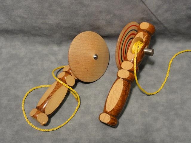

March 21, 20188 yr comment_144268 When making these tops the bottoms were easier to do in reverse cutting from the center out. I use reverse for sanding purposes mostly. Report

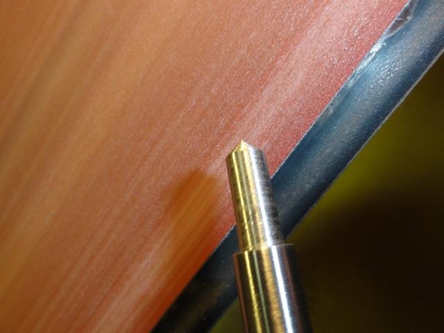

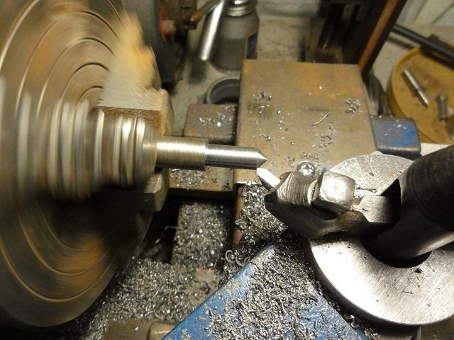

March 22, 20188 yr comment_144374 3 hours ago, RustyFN said: I like your tops. What are you using for the centers? Rusty, I have a metal lathe and took some metal rod and turned them for this project. The part that goes into the plastic decking material is turned to .260 so it is a press fit into a quarter inch hole. There is a hole drilled through the shaft for the string. Edited March 22, 20188 yr by HandyDan Report
