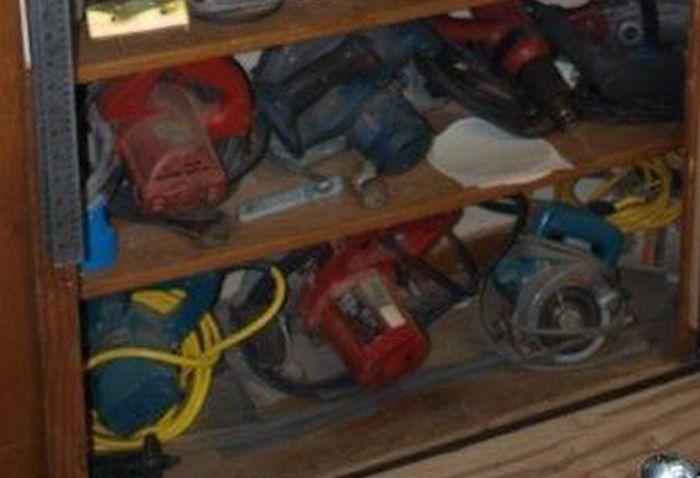

7 and 10'' circular saws w/ added OEM DC adapters..

any one of these saws fit the one plate including the 10'' CS and a Bosch..

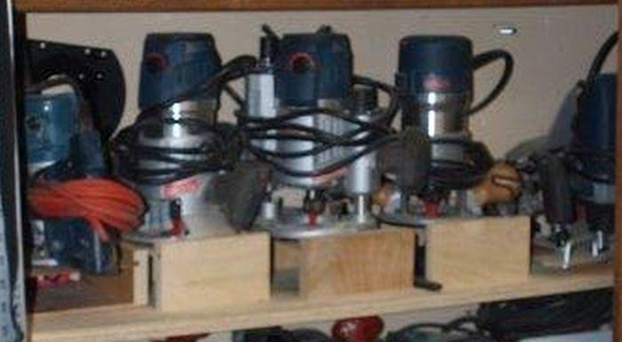

or any one of these routers... 1619v to the far right...
