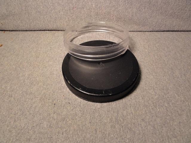

Seems like I am always tossing plastic containers with lids in the trash.  I got to thinking I might be able to use the threaded part of the containers and the lids to make turned boxes with threaded lids.  Well, it turns out I can.  Here is some of the containers.

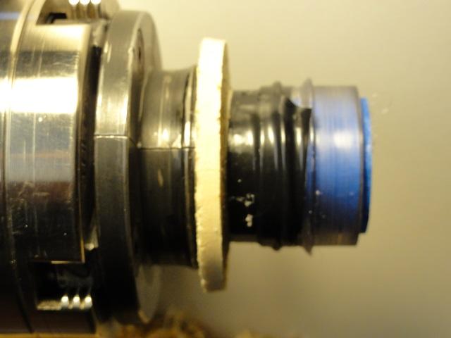

I take a knife and roughly cut the lid and threads from the container.  I always cut them with a down stroke with the knife for safety.  It is one of those operations where one slip can mean disaster.  After that I take a pair of tin snips and remove as much excess as possible to save time at the lathe.  I make a force fit carrier for the threads to trim them down for use.  The first one from the juice bottle had to have some painters tape added because I made the mount too small.  I taped them with some electrical tape to help hold them from spinning on the mount too.  I did a much better job getting the peanut container threads mounted with a press fit and no extras were needed to hold them in place.

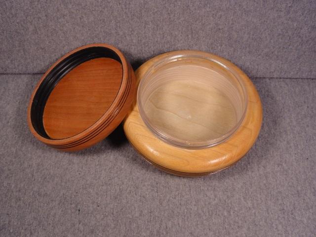

The was plenty of room below the threads to turn a flat area that could be epoxied into the box opening.  I used an epoxy made for plastic that I bot at the blue box store and tested it to be sure it would hold to the wood too.  I turned the sides of the lids to remove a small taper they had.

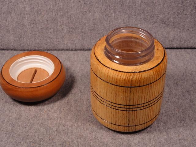

I went ahead and made a coin bank from the juice containers threads.  I rough turned the lid and inset the threads and then turned the bottom and inset the threads.
The lid was double stick taped to the face plate and I removed it and screwed it on the bottle and turned them to the same diameter and shaped them, embellished them and put some finish on.  Shellac in this case.

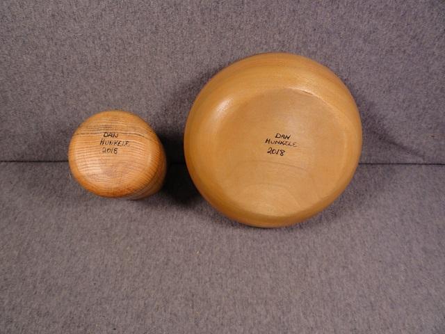

I took the lid off and turned the base around to finish the bottom.  Slid it back on the mount I made to trim the bottle threads.
Turned the bottom, signed it and put some shellac on it.  Cut a coin slot on the scroll saw and here is the end result.
Did a box with the peanut jar lid and threads using the exact same method.  I forgot to mention that I cut the threads off of the lid which left more wood visible under the lids
There is a lot of plastic jars these days so the supply and size is virtually endless.
