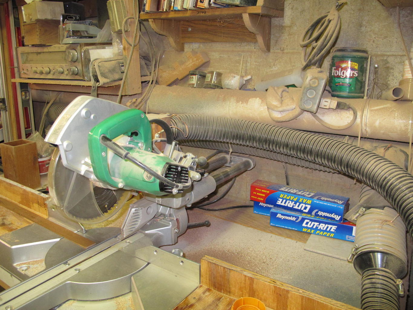

February 6, 20188 yr Popular Post comment_139653 Made a shroud. The scoop in the back of the tool platform is served by a 4" DC hose. MS is one of the most difficult dust capture challenges because of the particulate velocities, but this is about 85% effective. Works. Report
February 6, 20188 yr comment_139672 I like that, Pete. While a totally dust free workshop is a worthy goal, I think it's a myth. Report
