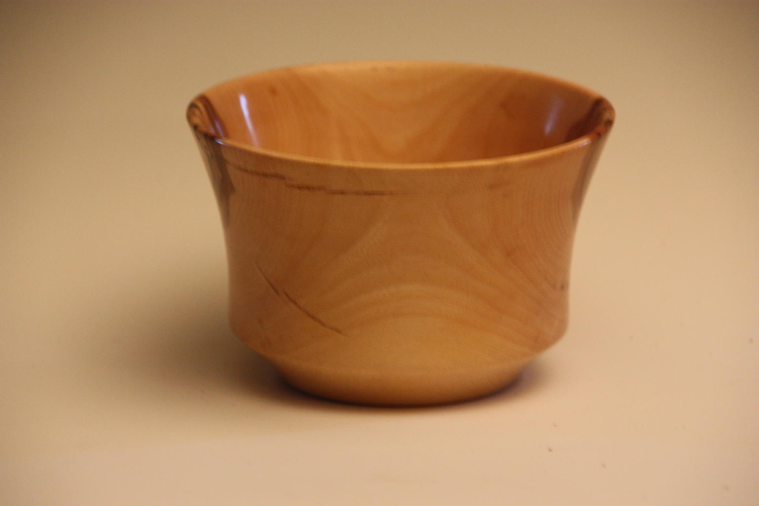

January 31, 20188 yr Popular Post comment_139009 The only experience I have had with it is turning . It turns well and makes a nice bowl. Eash to get a good surface turning.Not the best pic but just to get the idea Report

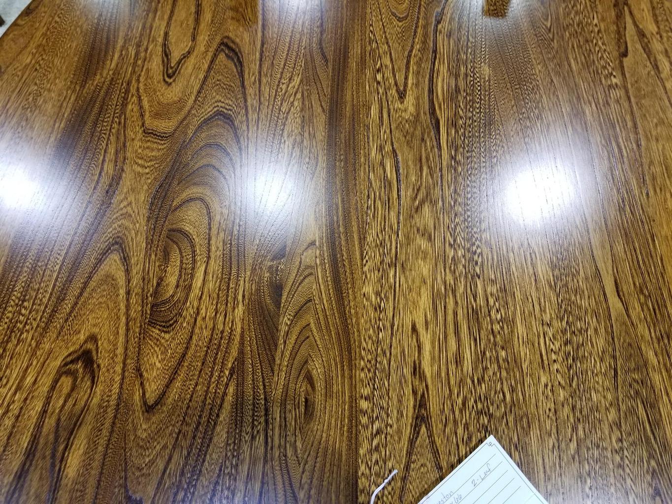

February 13, 20188 yr Author Popular Post comment_140395 Good afternoon all. Went to another home show over the weekend and the vendor with the elm table I mentioned in this post was there. I took a picture this time to share. Never posted a photo here before so hope it works. Apologies for the glare from the overhead lights. Edited February 13, 20188 yr by Wil Report
February 13, 20188 yr comment_140398 That is some gorgeous grain on that table. Those are really nice chairs too, @Dane Franco Report
February 14, 20188 yr comment_140404 1 hour ago, Wil said: Never posted a photo here before so hope it works. Ya' did good Wil...it worked just dandy. That is some of the most beautiful grain I've ever seen. Almost 3 dimensional. Some facets reminded me of pheasant feathers in color and texture appearance. Thanks for taking the time to take the picture and post. Report
February 14, 20188 yr comment_140423 Wow, that is really beautiful..............thanks for the pic! Report
February 14, 20188 yr comment_140426 11 hours ago, Grandpadave52 said: Ya' did good Wil...it worked just dandy. That is some of the most beautiful grain I've ever seen. Almost 3 dimensional. Some facets reminded me of pheasant feathers in color and texture appearance. Thanks for taking the time to take the picture and post. Had to go back and look. That grain really does look like a pheasant's tail feathers. Strikingly so. Report
