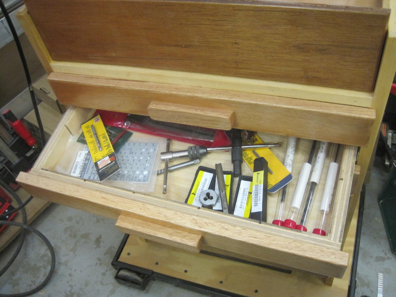

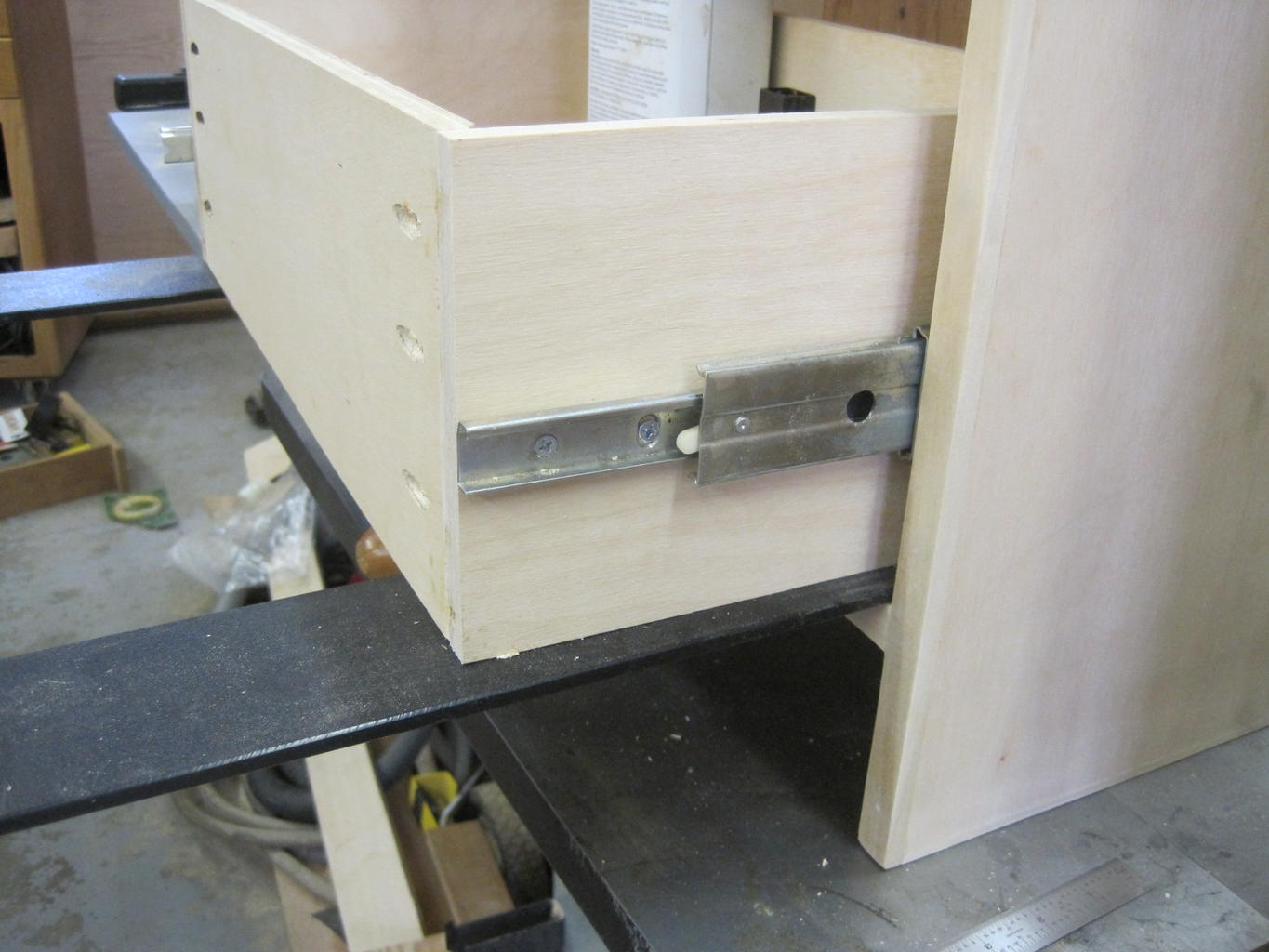

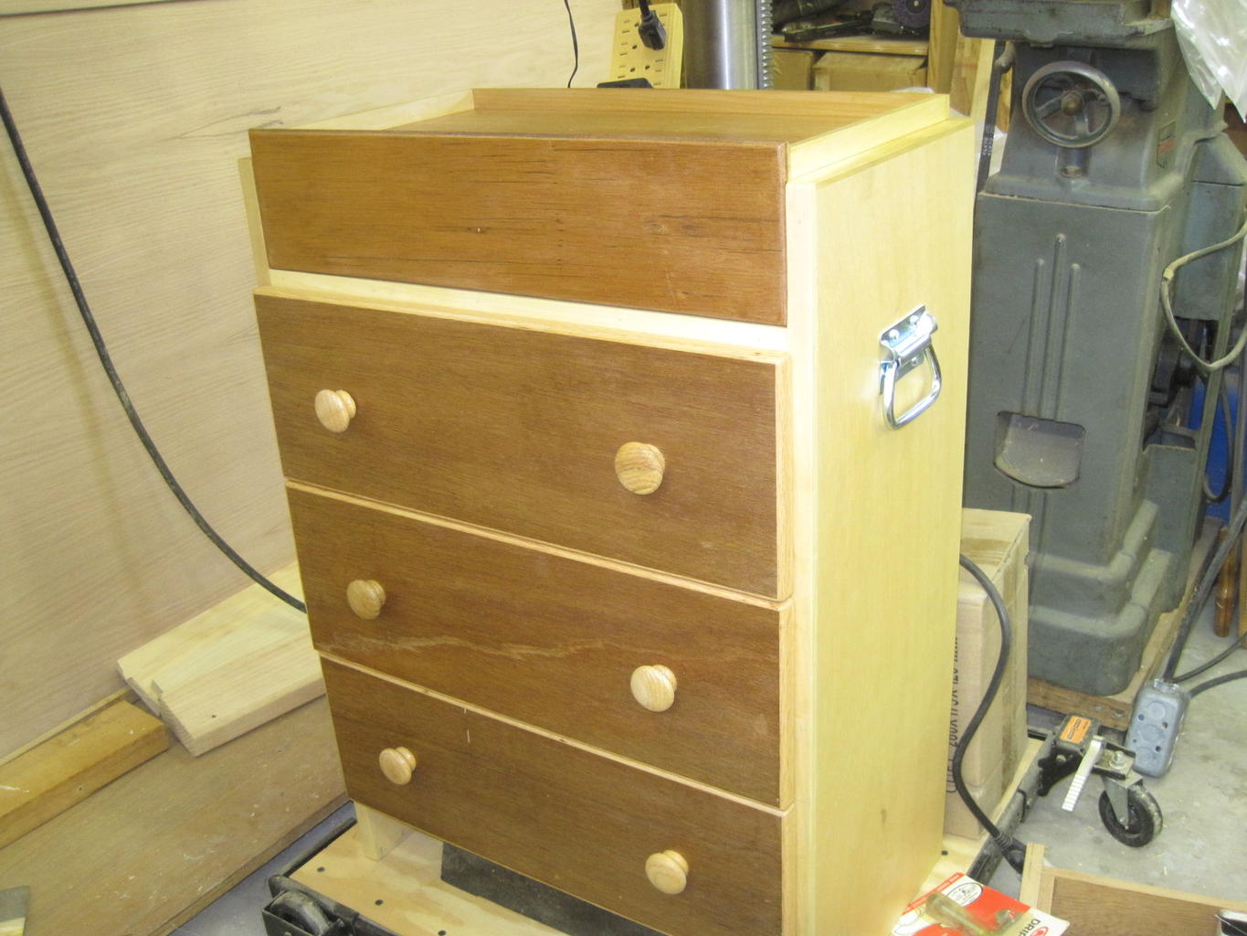

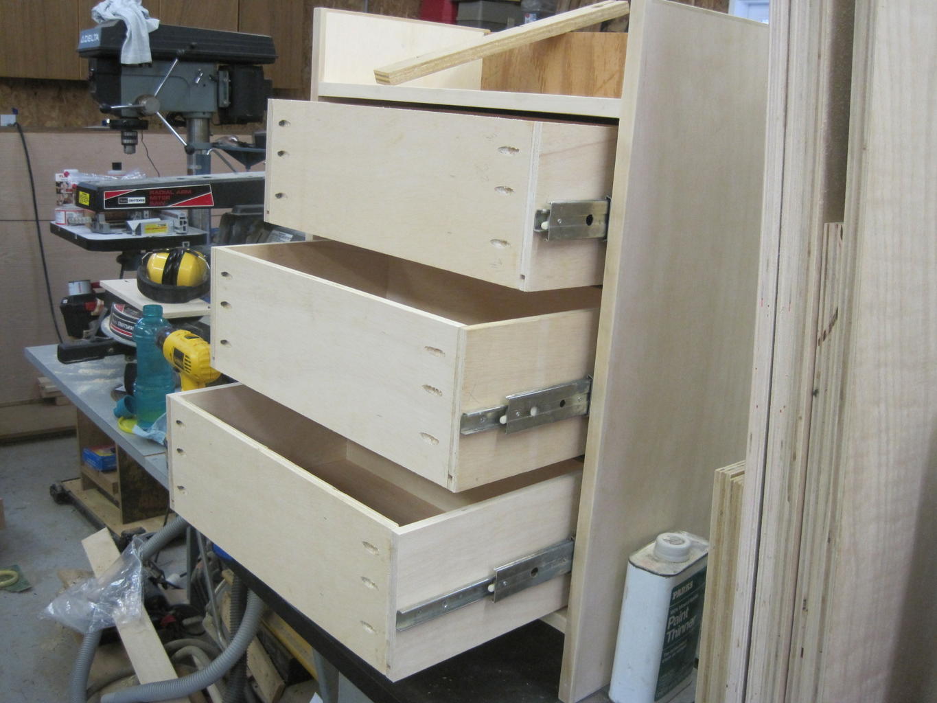

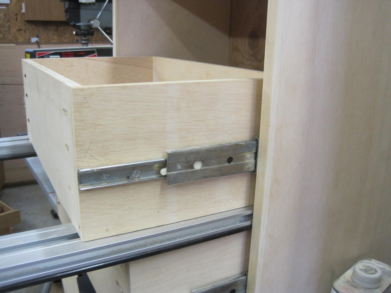

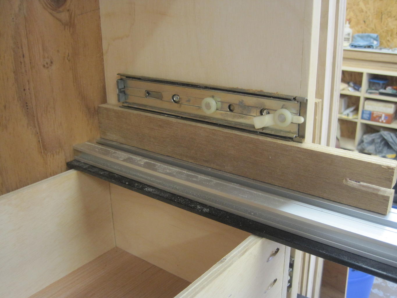

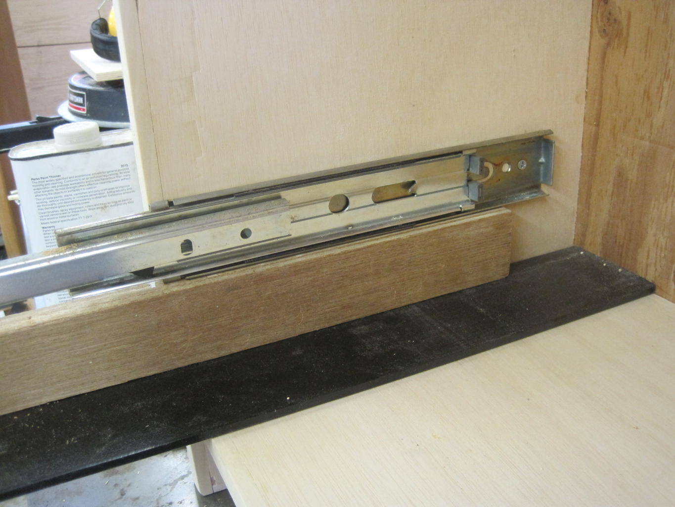

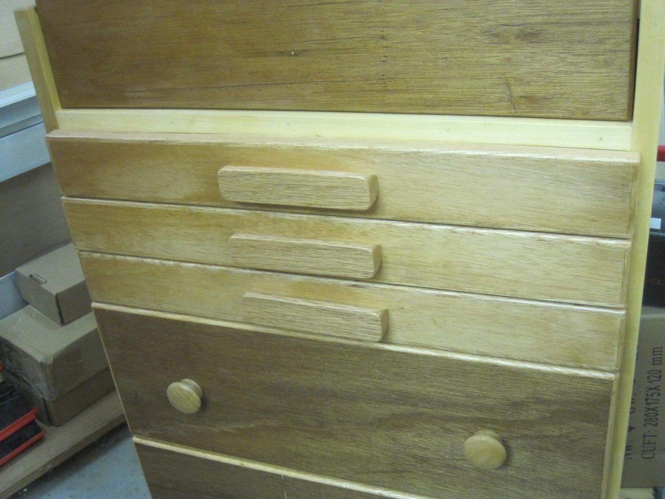

January 24, 20188 yr comment_138245 I do basically the same thing, add a step to move the slides up to about the center of the drawer which I prefer. The wider gap on top and bottom of the middle drawer was so that I could make all the drawer fronts the same height. This is the cabinet under my drill press, modified later to change the top drawer to three shallow ones which are more useful for storing drill bits, their primary function. Don't know why it put the photo in the wrong order, you need to look at them from bottom to top. Edited January 24, 20188 yr by tomp Added note - photos in wrong order Report
January 24, 20188 yr Author comment_138248 56 minutes ago, tomp said: I do basically the same thing my method is pretty much like yours.. and I don't use OSB either... Report

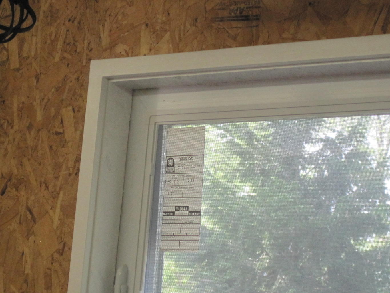

January 24, 20188 yr comment_138249 46 minutes ago, Stick486 said: my method is pretty much like yours.. and I don't use OSB either... Me either, at least not for inside projects. Learned my lesson when I used scrap OSB to fill in the gap between the window and the inside face of the wall in my garage/shop - thought I was saving money using leftovers until it came time to paint it. Like painting a sponge, I probably used all the money I saved in material for extra paint. Having said that, I can remember my father getting a piece of "furniture grade" chipboard - small chips, very dense and smooth, guessing from Scandinavia because that was the big thing at the time - that he used to make a table top. He nailed wood edging around it and put on about 6 coats of varnish. This was before I left home, so around 1960 or so, and it was something new they were showing at a local home show there in Edinburgh. Report
January 24, 20188 yr Author comment_138250 8 minutes ago, tomp said: thought I was saving money using leftovers until it came time to paint it. Like painting a sponge, should of painted the other side... Report
January 24, 20188 yr comment_138252 2 hours ago, tomp said: This is the cabinet under my drill press, I like it Tom...very nice. Report
