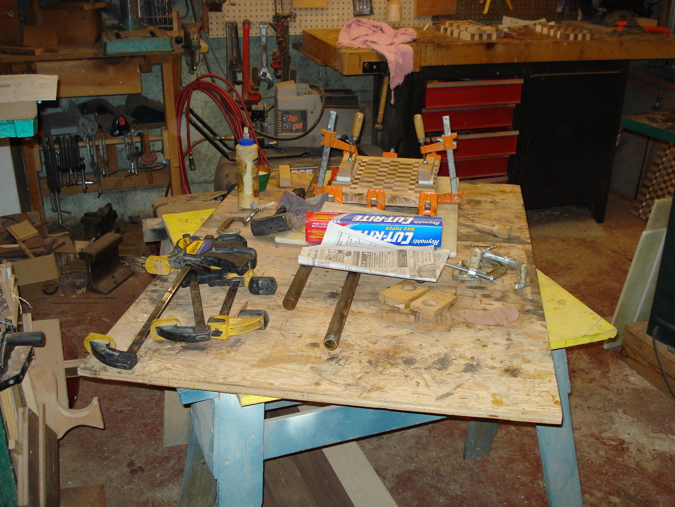

I have a similar setup that uses a reclaimed lazy susan bearing. 2 large pieces of plywood that sandwich the bearing. Sets on a pair of sawhorses when in use. A thru peg keeps it from rotating when I need it to be rigid.
