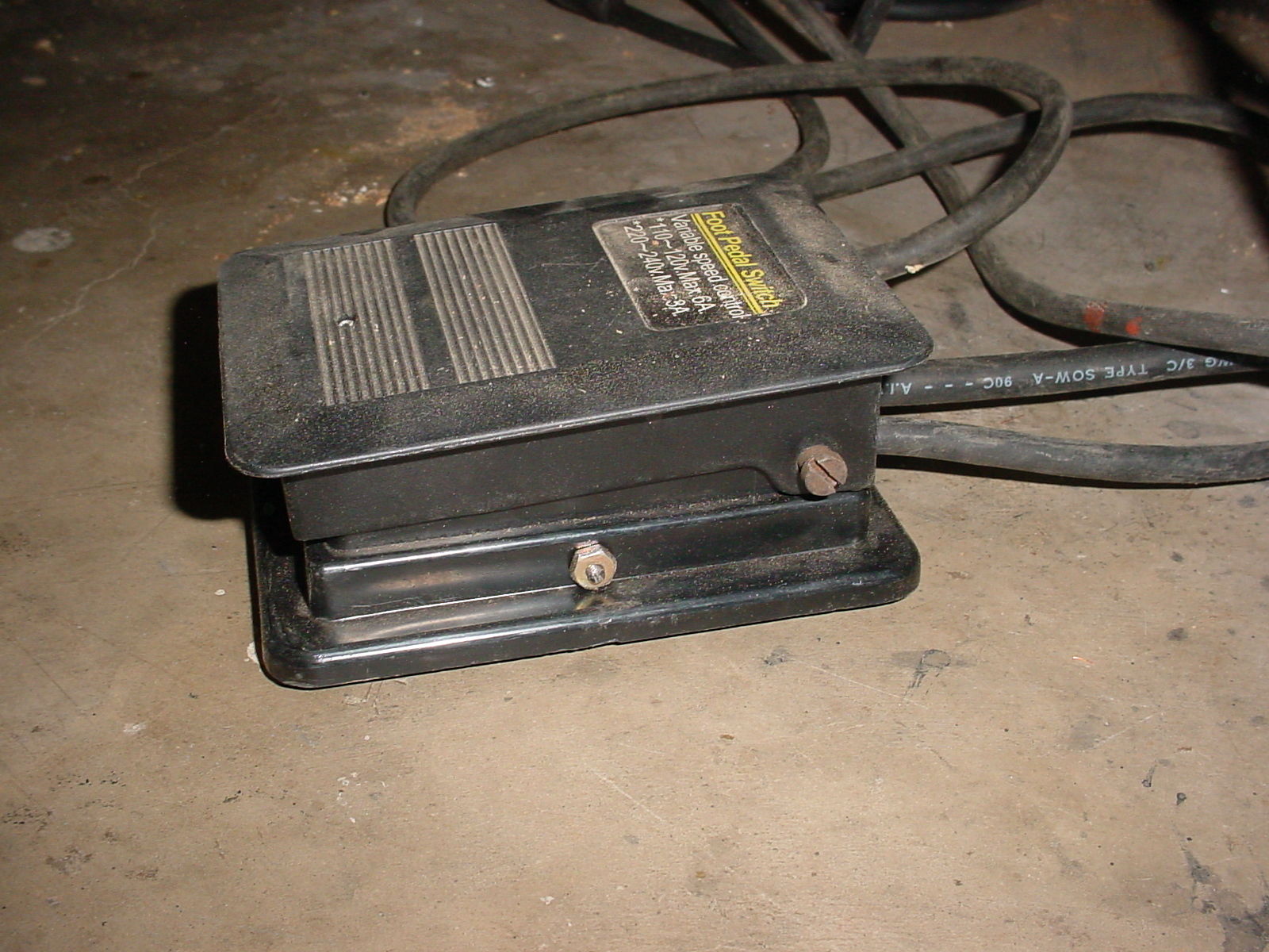

I'm using 12000 volts.
I use hand off probes.
I use a foot switch.
You can control where you want the arc to go.
