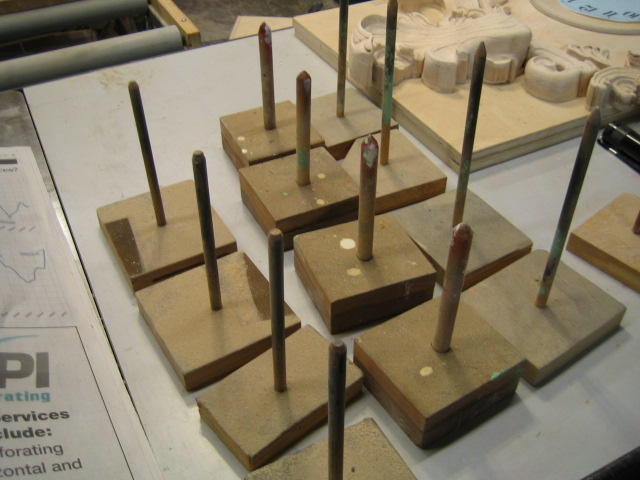

Keith I spray lots of frames and I need the things off the table so I can get a sprayer in there. These dowels if I don't want the pointed end I can flip them upside down for when I spray heavier things. Those things you went to the trouble of making seems like sitting on the flat table is about the same.IMG_9700.JPG.ec71feba31f798caeb05f268736dc054.JPG
