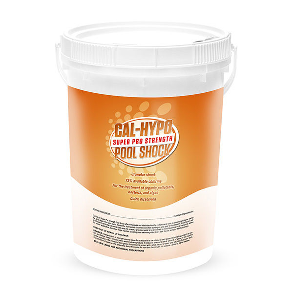

Chlorine Bleaches
Laundry bleach (e.g., Clorox), sodium hypochlorite, NaClO, is a weaker type of chlorine bleach.   A stronger version is a pool bleach, calcium hypochlorite, Ca(ClO)2, that you can get at pool supply stores.
To use, stir a pool bleach in hot water until you get a saturated solution (will not dissolve any more bleach powder).  Apply liberally to wood soon after mixing.   It may need to work overnight.   You can repeat once if needed. Additional applications beyond two are usually not effective. Using laundry bleach (Clorox) is usually not effective except on the lightest of stains.
Chlorine bleaches are best used for removing dye-based stains but not effective on pigment-based stains.   They are also effective on food or beverages that have penetrated a finish and made a stain.  It does not obscure the natural color variations in the wood.
