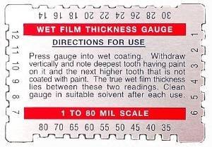

There is a device called a "wet mil gauge" that helps you measure the wet film thickness to see it is within the specs for the product you are applying.  Once you get a feel for it, you can probably judge the right thickness.

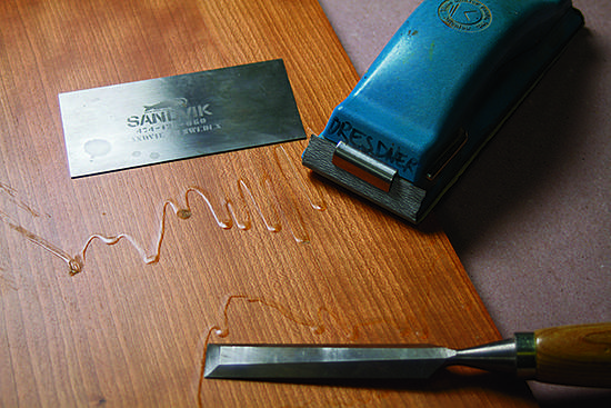

In either case, if you catch the drip/run while it's still fairly wet, you can cut back the thick spot with a brush.   If it's started to cure/dry leave it so as to not make it worse.
Repair
If you don't catch it in time, you will have to wait until the area is fully cured.   This can take days for thick layers of oil-based varnish.  Then cut back the high spots with a scraper or sandpaper.   You will then need to apply another coat of the same finish.
