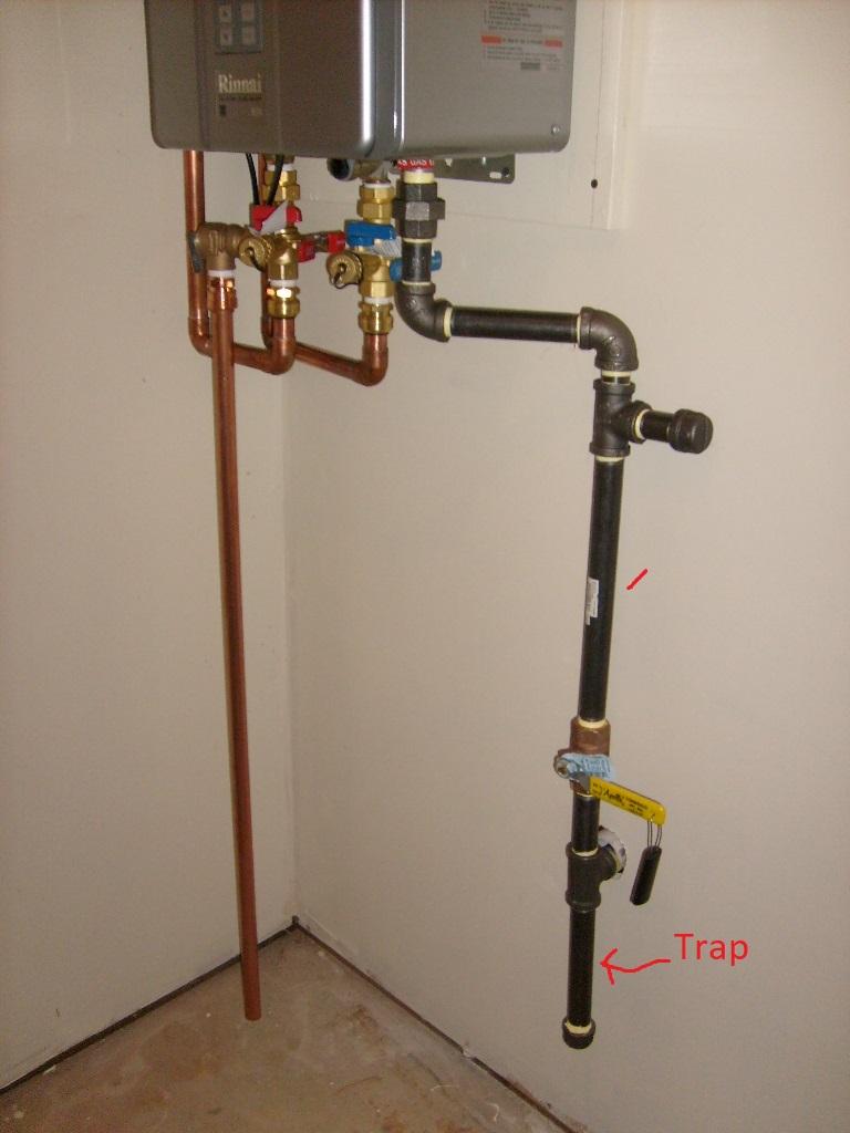

November 15, 20179 yr comment_131432 Black pipe is a good idea if it is going to be exposed. The pipe dope acts like a lubricant and if you are strong like bull and tighten it too tight the cast connectors can crack. Don't forget to add a sediment trap at the bottom of the run. Edited November 15, 20179 yr by HandyDan Report

November 15, 20179 yr comment_131455 2 hours ago, HandyDan said: Don't forget to add a sediment trap at the bottom of the run. Absolutely! Great reminder! Report
