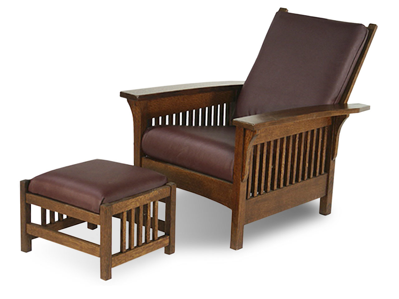

Tight spots
If your piece has lots of tight spots such as spindles that are close together, staining and finishing before assembly will be easier than trying to get your rag and/or brush into those areas.  (And I've found it's way faster to spray things like chairs than to rag or brush).
5400_Morris_Chair_and_Ottoman__54228.150

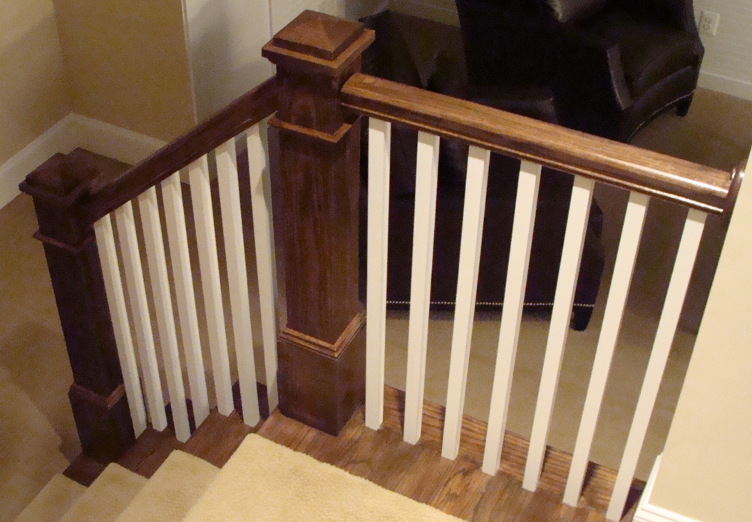

terrific-wood-stair-balusters-stair-spin
