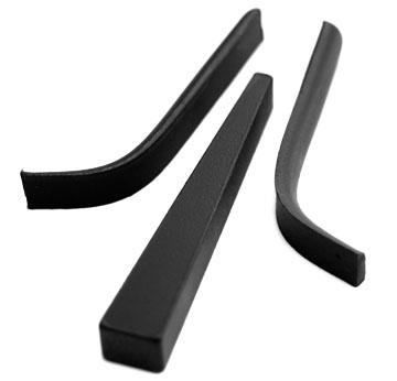

November 14, 20179 yr comment_131287 38 minutes ago, Cliff said: I considered that this tool might let me drill the rocks enough so's I can bust em with my forged iron bar. use plan ''B''... that'd be Wedge and Feathers.... they gotta be the oldest and still one of the best ways to split stone/rock/granite... they come in small, medium, large and extra HD/tough/gimme me some room here for granite...... Report
