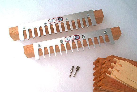

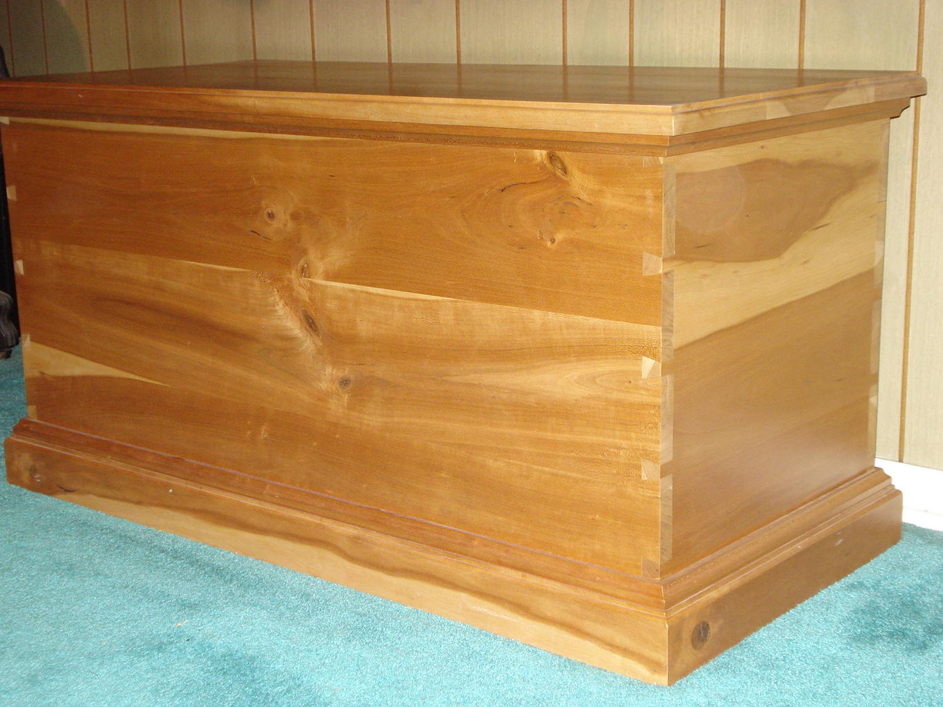

October 25, 20179 yr comment_128995 Love my Keller jig. Very simple, and the length is endless, for obvious reasons. I had a blast with these chests. I have the model 1601, Dad purchased it back in the mid 80's, he gave it to me. The image below is the Keller website image, I was looking for a pic of mine in use but can't find one. Report

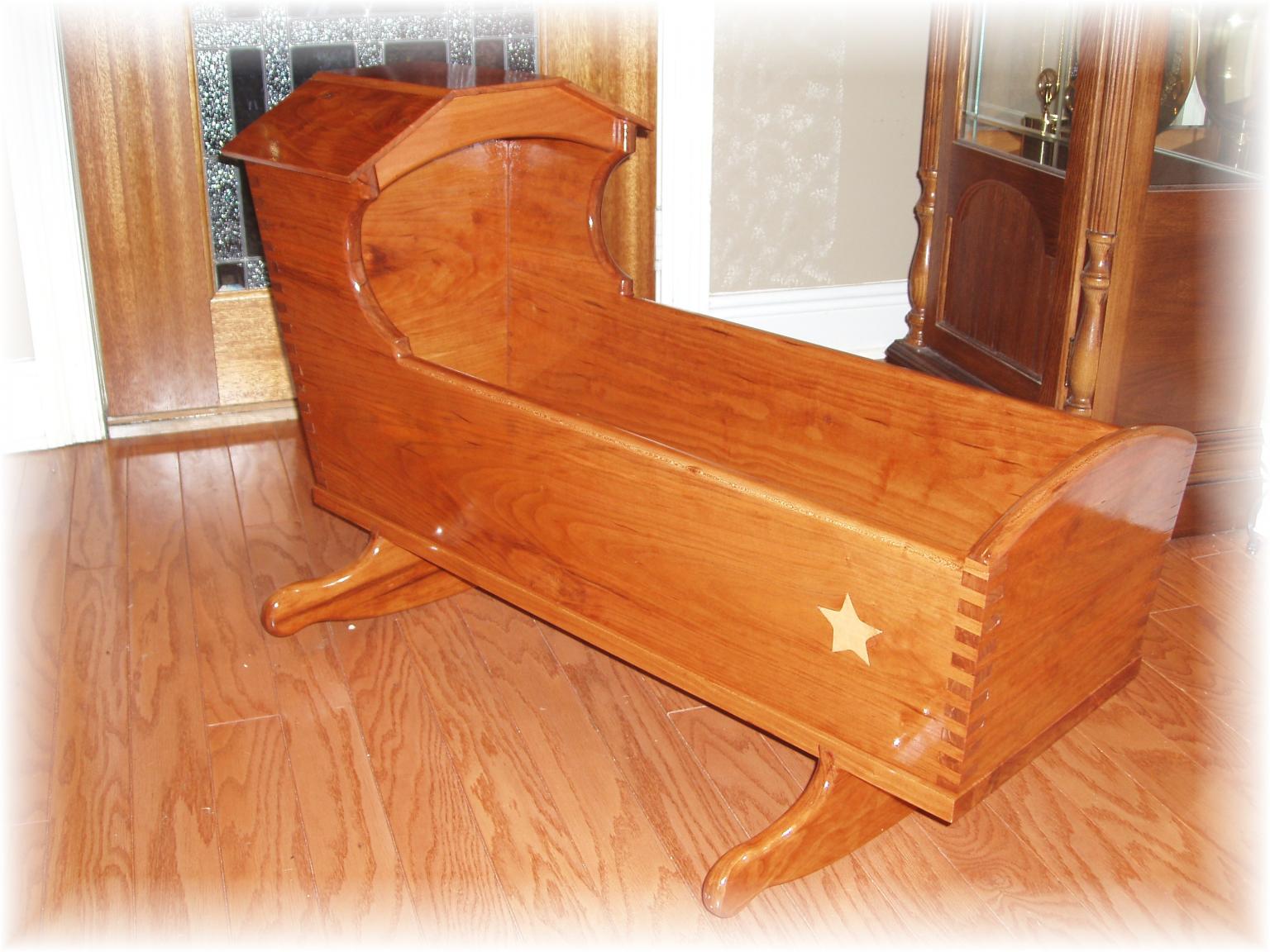

October 25, 20179 yr Popular Post comment_129045 I have a Keller also and used it on the cradle. Report
