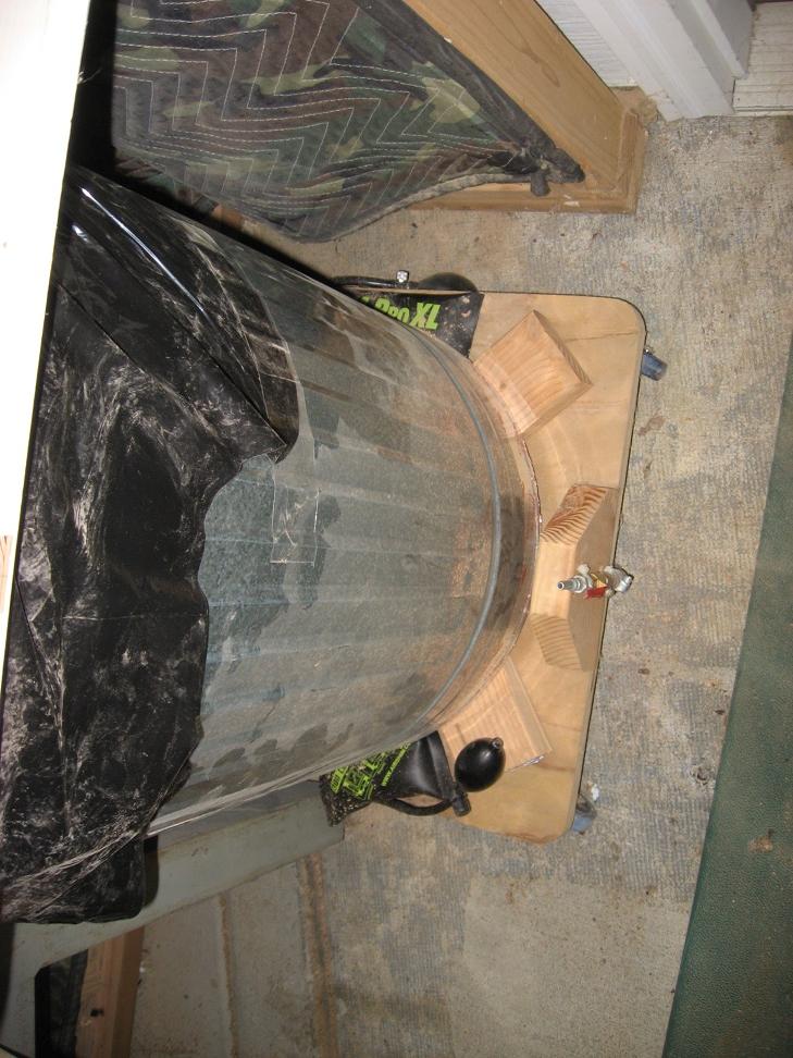

September 20, 20179 yr comment_125255 Update on the AirShims, they arrived today and are smaller than I had thought. Good thing I ordered 2, I can use one on each side of the dust bin to raise it ,then slide in the wedges to hold it. Herb Report

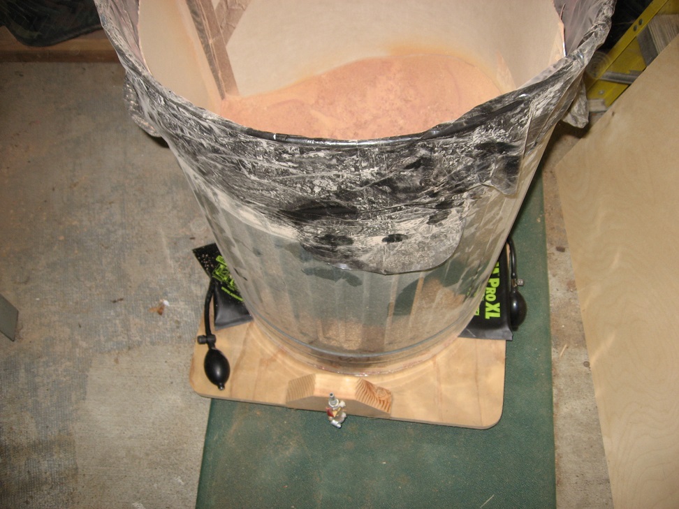

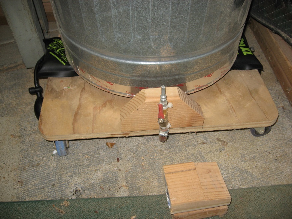

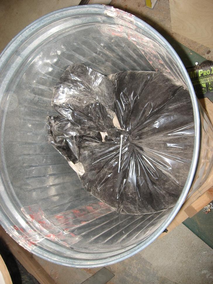

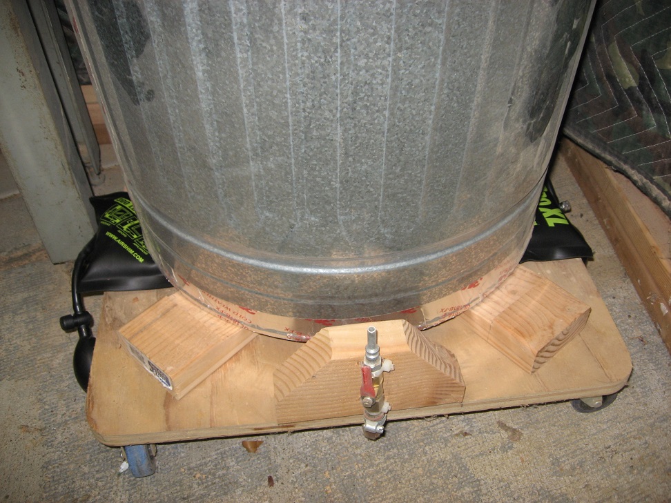

September 21, 20179 yr comment_125457 On 9/19/2017 at 7:41 PM, Grandpadave52 said: Pictures, pictures...did I mention pictures? OK,Dave, stand back here they are in action............. Not sure why the last one is sideways, it wasn't til I posted it. Oh well you get the picture. Herb Report
September 22, 20179 yr comment_125477 3 hours ago, Dadio said: OK,Dave, stand back here they are in action............. You"re a good man Herb. So, whadda' think? Better than before? Easier to use or about the same? I realize yours is kind of a one-off application, but now that you've done it, satisfied with the results? Report
September 22, 20179 yr comment_125482 38 minutes ago, Grandpadave52 said: You"re a good man Herb. So, whadda' think? Better than before? Easier to use or about the same? I realize yours is kind of a one-off application, but now that you've done it, satisfied with the results? A lot easier Dave, Before I didn't have enough hands to pump up the inner tube and try to line up the bin with the groove in the top. This way I can pump it up til it is just snug and shake the can back and forth and it pops into the groove and I can then pump it up hard and it holds while I slide in the wedges. I am grateful to Ron for posting this. Herb Edited September 22, 20179 yr by Dadio Report
September 22, 20179 yr comment_125485 22 minutes ago, Dadio said: A lot easier Dave, Before I didn't have enough hands to pump up the inner tube and try to line up the bin with the groove in the top. This way I can pump it up til it is just snug and shake the can back and forth and it pops into the groove and I can then pump it up hard and it holds while I slide in the wedges. I am grateful to Ron for posting this. Herb ...glad it fit your niche and especially made things easier...haven't ordered any yet, but I'm going to look into these. A couple of non-woodworking uses came to mind... Thanks Herb for posting your application, pics and story. Report
