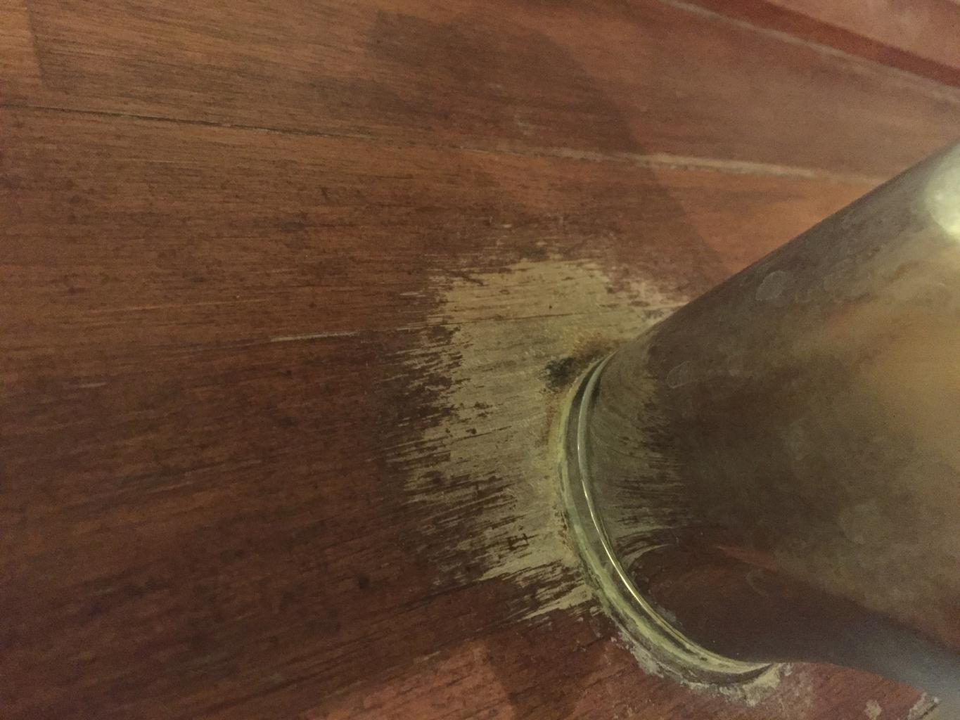

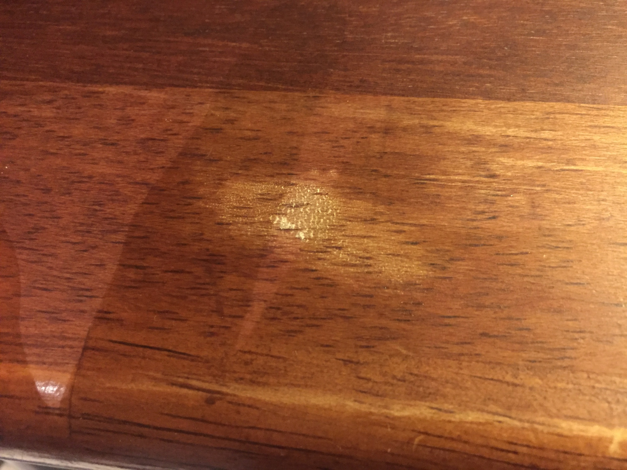

stole your post and sent it to a guy in Sweden... you are now world renown...

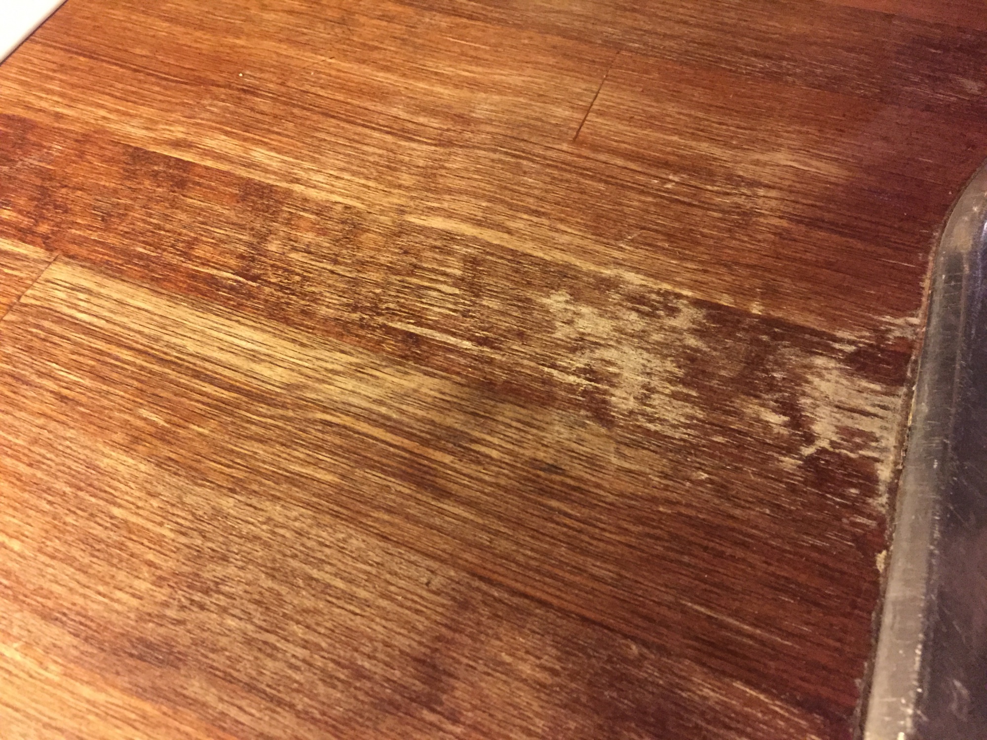

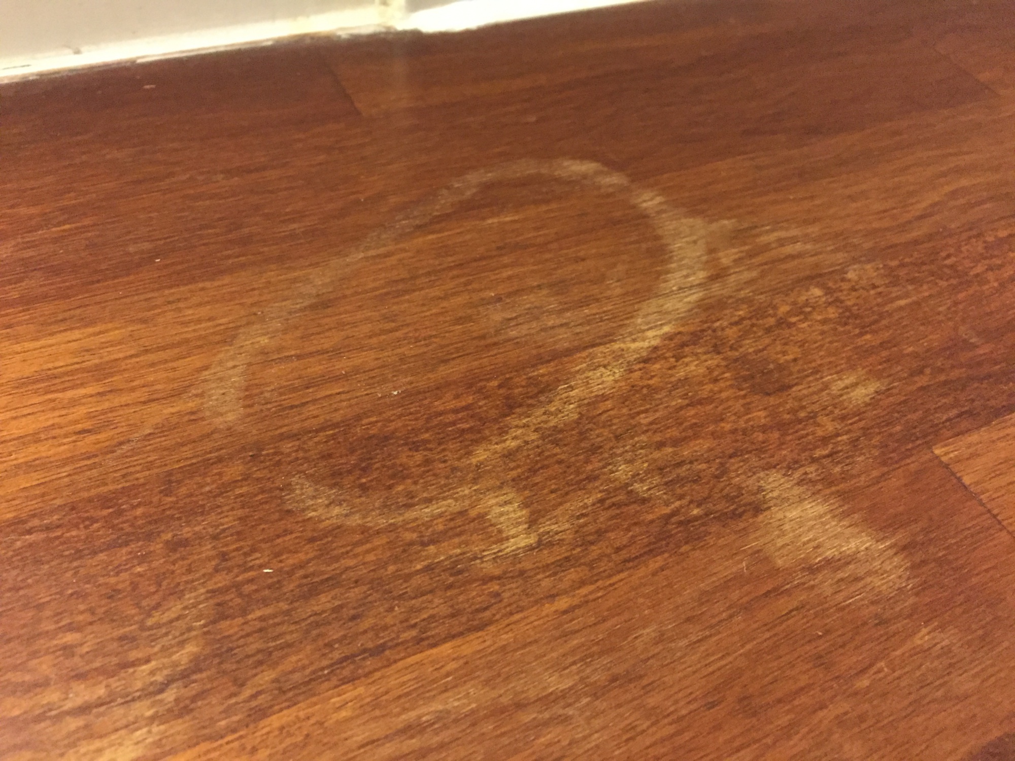

his issues w/ a counter top... (that first pic doesn't look like a water mark)....
1r.thumb.jpg.9f2928baa60f1096a26dd12793ca3b21.jpg2r.thumb.jpg.64cda8bbb0ff19dec9c5f05bdb639c75.jpg3r.thumb.jpg.2c08731b3988eab10699cab460dba6d0.jpg4r.thumb.jpg.49690b75d34bf5cd71c0ee9c28401aac.jpg
