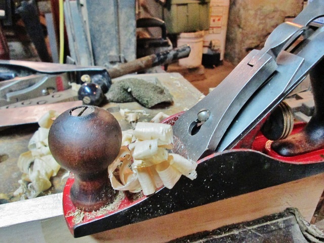

Paid $3 for a small plane last weekend..
Closing Time Cutey ?   Was marked as $7.....Got around to a rehab this morning..
Sears must have ordered a LOT of red paint....
Took less than an hour to clean it up..
Got rid of the ugly red finish, most was gone, anyway.  Flattened the back of the iron, tuned the chipbreaker, bolt handle bolts needed shortened.  BLO wipe-on, wipe-off on the handles.  Test drive?
Seemed to do ok on Maple.
Might be worth the $3?

BTW...nice job on the #3 Dunlap...any guess on the age? I see it has brass screws for the tote and handle...late 40's, early 50's??
Might be just after 1962,,,when Stanley started folding the old "whaletail " lateral levers.
BTW:   When a tool is marked as "Dunlap Approved"  it was because of a fellow named Dunlap that worked for Sears & Roebuck back in the day.   He would approve a tool maker's submitted line of tools, to be sold by Sears & Roebuck.
Thinking this little plane was made by Stanley....
