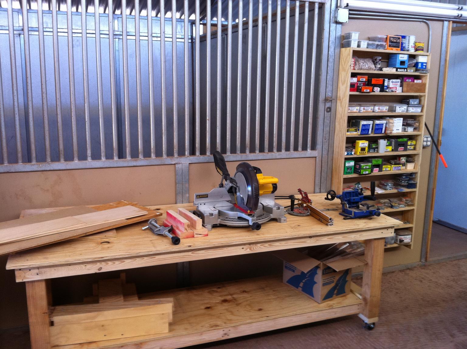

August 9, 20179 yr Popular Post comment_119872 one of mine: they are all on lockable casters with a lower shelf for stuff and leg stability. 36x96, about 34 high (1/2 less than TS height, useful for infeed and outfeed use). Report
August 9, 20179 yr comment_119887 1 hour ago, DAB said: one of mine: they are all on lockable casters with a lower shelf for stuff and leg stability. 36x96, about 34 high (1/2 less than TS height, useful for infeed and outfeed use). I have one of those but without the wheels! Report
August 9, 20179 yr comment_119890 2 hours ago, DAB said: one of mine: they are all on lockable casters with a lower shelf for stuff and leg stability. 36x96, about 34 high (1/2 less than TS height, useful for infeed and outfeed use). Is 36x96 a workable dimension, i.e., would you change anything??? Still pondering my assembly table to be. Report
August 9, 20179 yr comment_119905 1 hour ago, kmealy said: Is 36x96 a workable dimension, i.e., would you change anything??? Still pondering my assembly table to be. works great. can reach the far side if it's against the wall, or now, i have a bench with access on all sides. any wider would be hard to reach the far side. very sturdy. i later moved from where this pic was taken (old horse barn) to my new shop. loaded these into the back of my truck, pulled them out, flipped on their sides to clean off with a hose, and then wheeled them into place in my new shop. held together with deck screws of varying lengths. you can see the basic construction and adapt for your own space availability. i have one on the infeed side of my TS, and used to have one on the outfeed, but i built a dedicated outfeed table. very handy for running sheet goods thru the TS. casters make them really useful. easy to move where you want them. Report
August 9, 20179 yr comment_119916 Sheet goods BCX or something like that? Ever considered melamine-coated MDF? We use a lot of that at the furniture bank. Where'd you get the casters? Report
August 9, 20179 yr comment_119917 6 minutes ago, kmealy said: Sheet goods BCX or something like that? Ever considered melamine-coated MDF? We use a lot of that at the furniture bank. Where'd you get the casters? the ply is pretty rough, likely CDX. plywood is tougher than MDF. long ago i had a bench that i had covered with scrap laminate. really easy to clean when you spill glue or stain. casters from home depot. 2 are lockable, on one side. plus, if you need to, you can screw to plywood. my main one (not shown) has a vise on one end and bench dog holes along the length. it's really beat up now. drill holes, stain spills... Report
