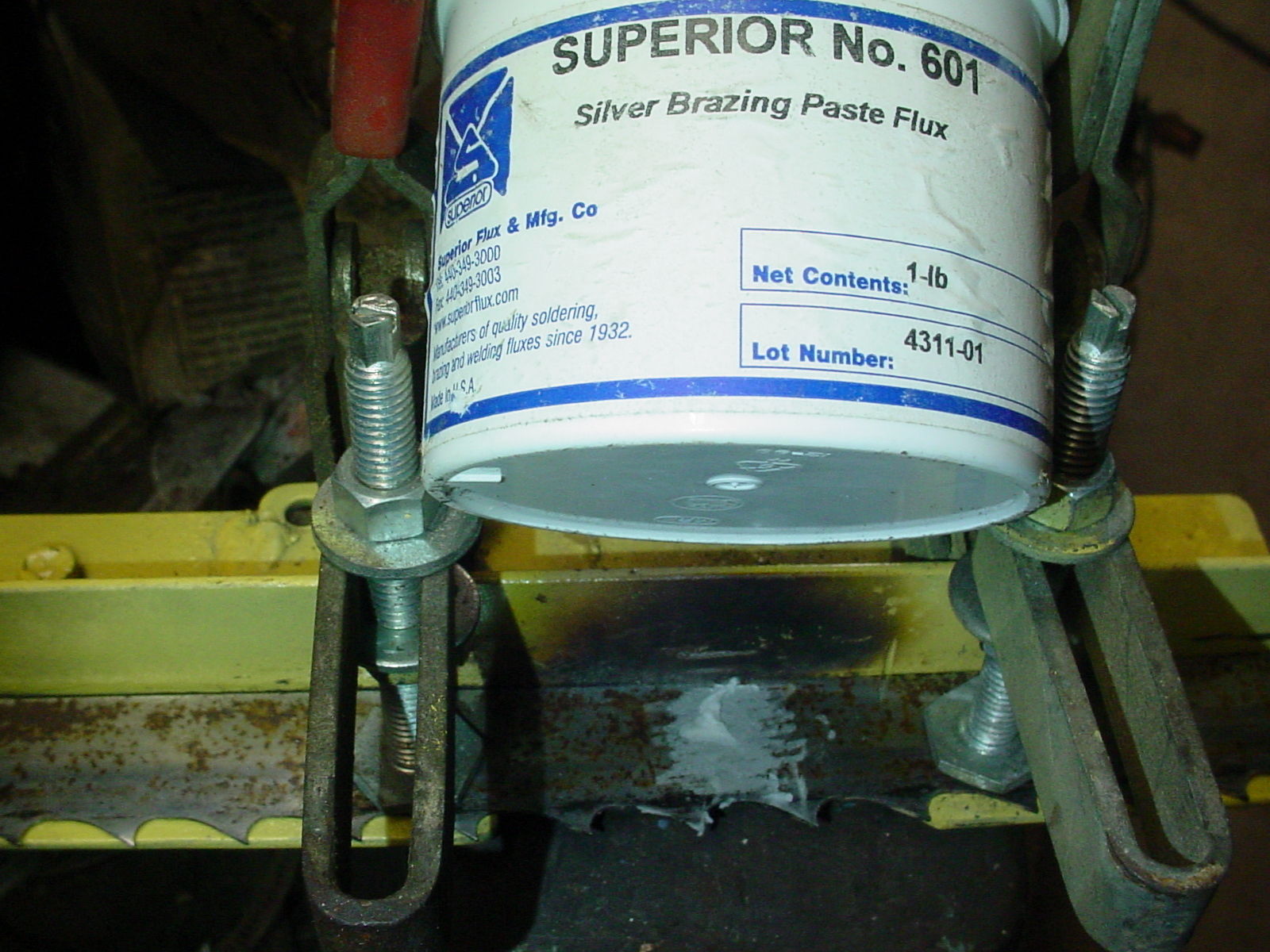

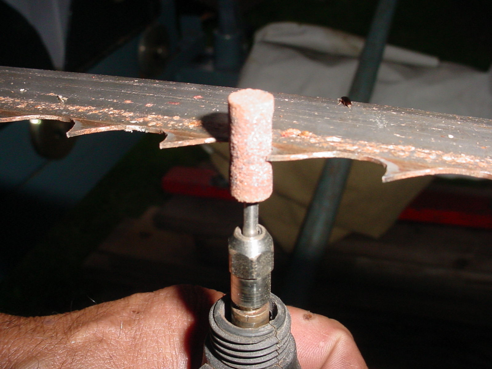

September 23, 20197 yr comment_202563 I buy blade bands in rolls and make my own. At first I silver soldered them then I bought a blade welder. Now I take small cut off wheels and sharpen my blades right on the saw. I use a dremel on larger bands. I also made a saw set for bands. Report
September 23, 20197 yr comment_202566 Kevin , You may not have noticed the date of the last post on this topic, July 2017. A bit more information on what you use and how to sharpen the blades using the dremel would be appreciated. Report
September 24, 20197 yr comment_202569 3 hours ago, Kevin Beitz said: I buy blade bands in rolls and make my own. At first I silver soldered them then I bought a blade welder. Now I take small cut off wheels and sharpen my blades right on the saw. I use a dremel on larger bands. I also made a saw set for bands. If you would not mind make a post about it. My Dad told me he had a blade welder in High School Shop, but I have never seen or used one. Report

September 24, 20197 yr comment_202608 14 hours ago, Al B said: Kevin , You may not have noticed the date of the last post on this topic, July 2017. A bit more information on what you use and how to sharpen the blades using the dremel would be appreciated. A lot of videos out there Al but here is a short one that gives the idea of how it is done. Doing it on the saw is easier in my opinion. Works surprisingly well too. Report
