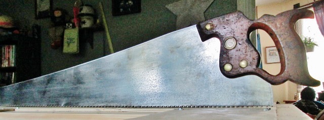

Hmmm, did not take all that long to do...
Found enough brass bolts that fit the handle, and went together easily.   Had one small kink at the tooth line,,,hammered that out.   Haven't decided about refinishing the handle, yet
Was a bit distracted, I also got the new screen door ready to install.   Pet door is installed, screen guard has been cut to size and installed.  Need to  demo out the old door, and install the new.....then the Boss can paint it up.. Saw took less than an hour to do...I am getting slow in my dotage....
I'll see IF I can bring out the etch a bit better, later today...  Might be an Atkins No. 59?   Or something like that....we'll see...
yep..No. 59 is in the etch.    Found a few lines of script to the tight of the main etch...still trying to read them...
Blade length is 24".
Gun Blue Paste:   Smear a coat on where you need it.    Wipe off the excess.   Then LIGHTLY sand the metal  with either a sanding block or a palm sander using just the weight of the sander
Etch sit deeper ( not by much..) then the surrounding plate.   Just need to  remove the blue on the high spots.
