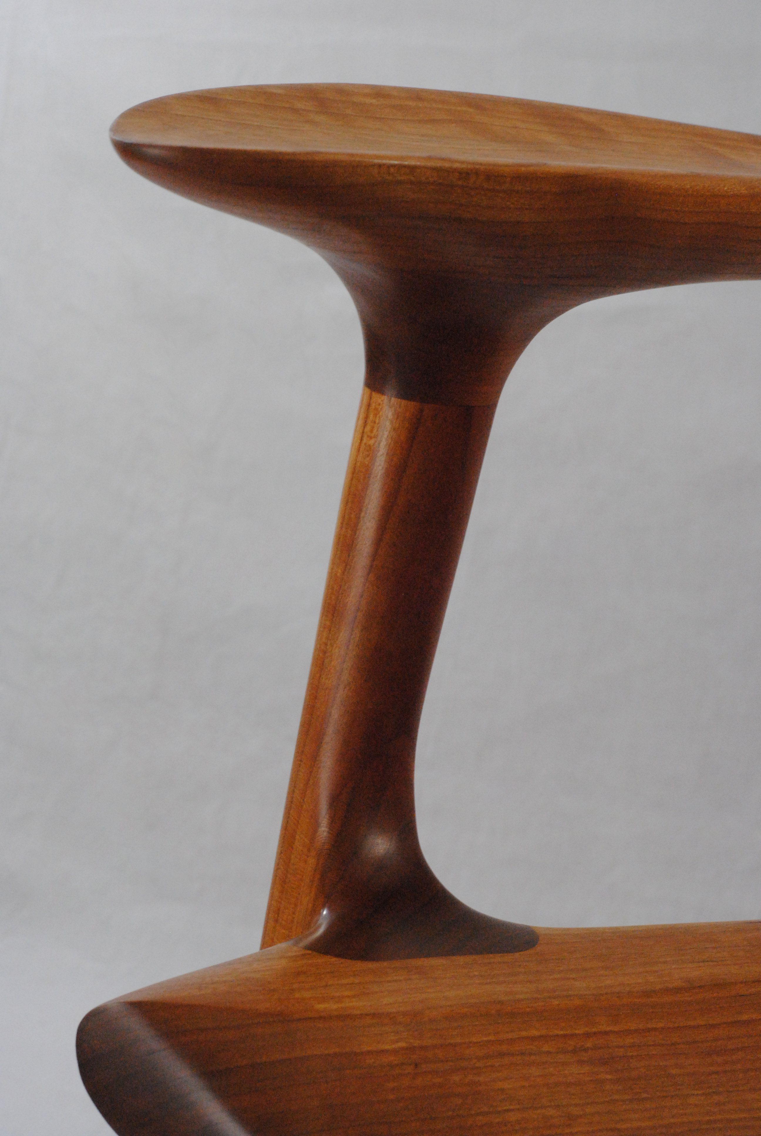

June 23, 20179 yr Popular Post comment_113960 31 minutes ago, Dadio said: Careful, you will be cited for clamp abuse..........Just joshing. I have had some small irregular pieces that there was no way I could clamp them, so I just held them in place for a minute , and then set them down to dry ,and they set up fine. One I even had to remove because I twisted it while holding it and a day later, it broke out wood around the joint, , after that instead of knocking it off I sawed it off to keep from damaging the piece it was glued to. Ever tried to get a knob of glue off your workbench after it sets? It hasn't had any clamping and it is tough to remove. Just saying, Herb Most definitely Herb, I agree. I guess I should have also prefaced my over torquing of clamps with, it's necessary, for the type of joints found on my rockers and any sculpted rocker for that matter, the joint has to be tight, very very tight. I clamp the way I do more for assurance that the glue line does not look like a glue line, but a beautiful joint of wood to wood, an invisible line. These joints in the chair making business is what we call the "Money Joints". If you blow this joint, the whole chair seat is wrecked, there is no turning back from it, so over torquing is an insurance. My Cherry Rocker below, showing the joint, it has to be perfect. I'll even take channel locks and put it up on the handle of my bar clamp and torque it even more. Before anyone gets on me about my channel locks method, it's a common practice in this type of chair building, so back off! Report
