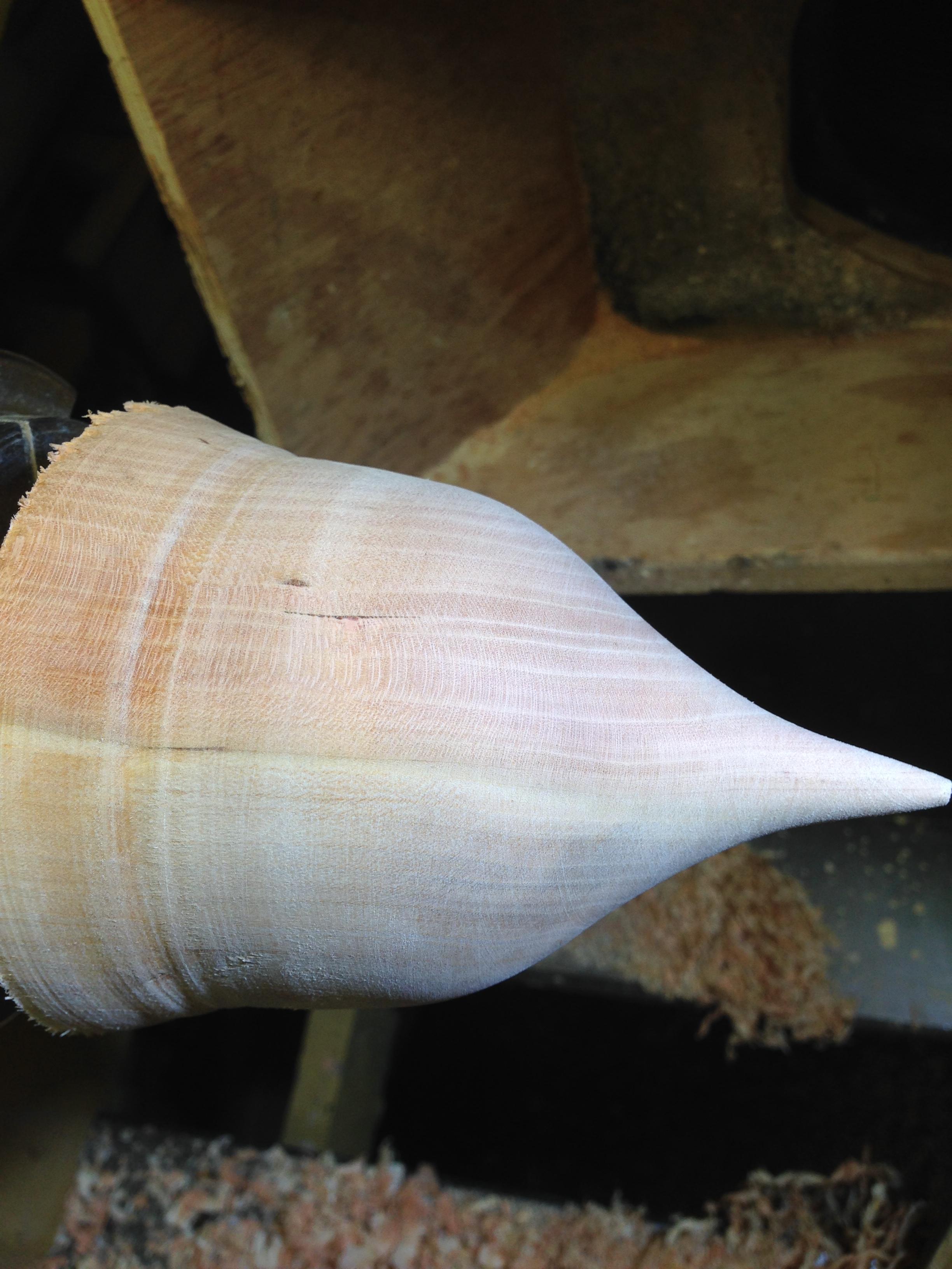

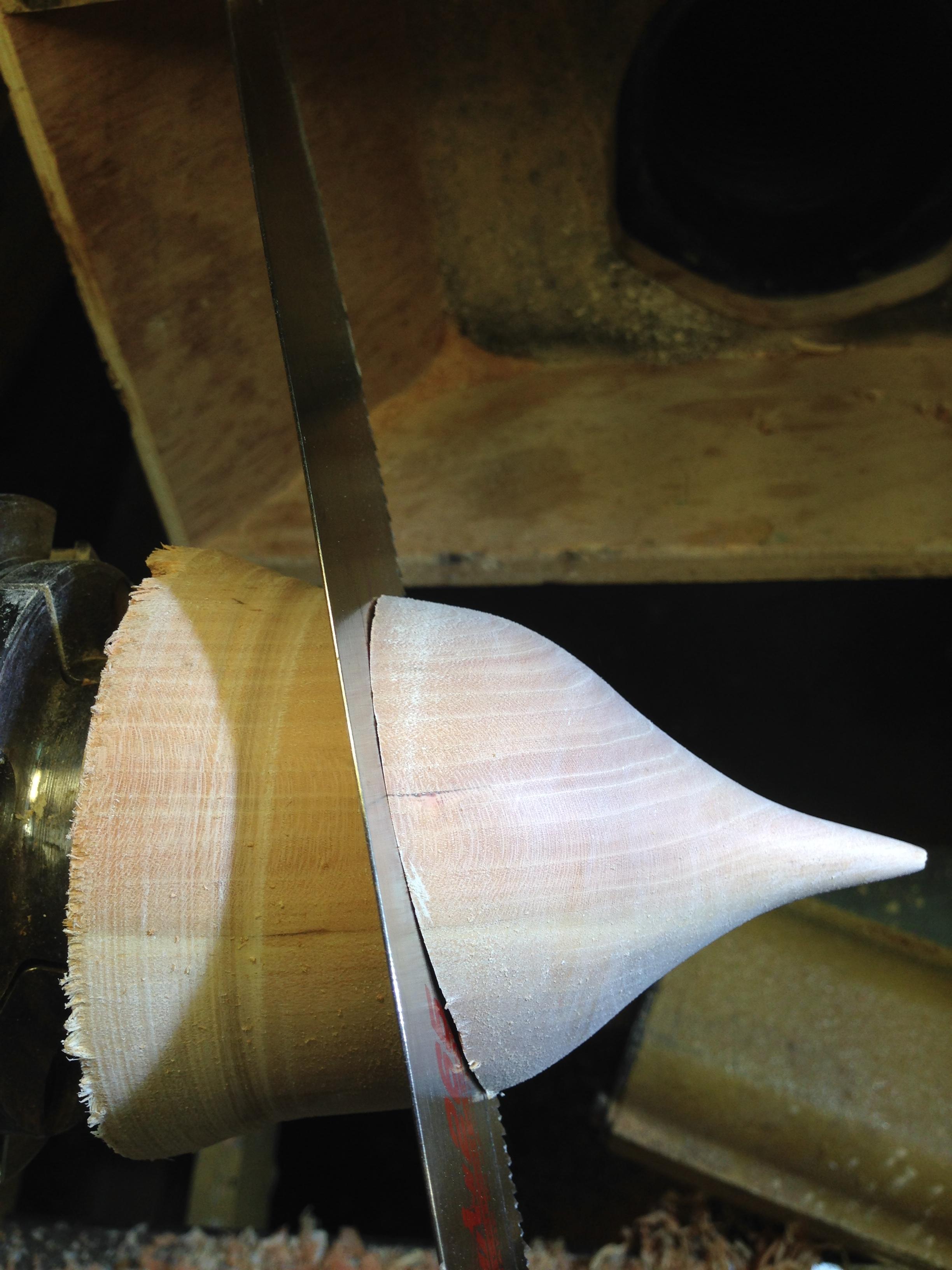

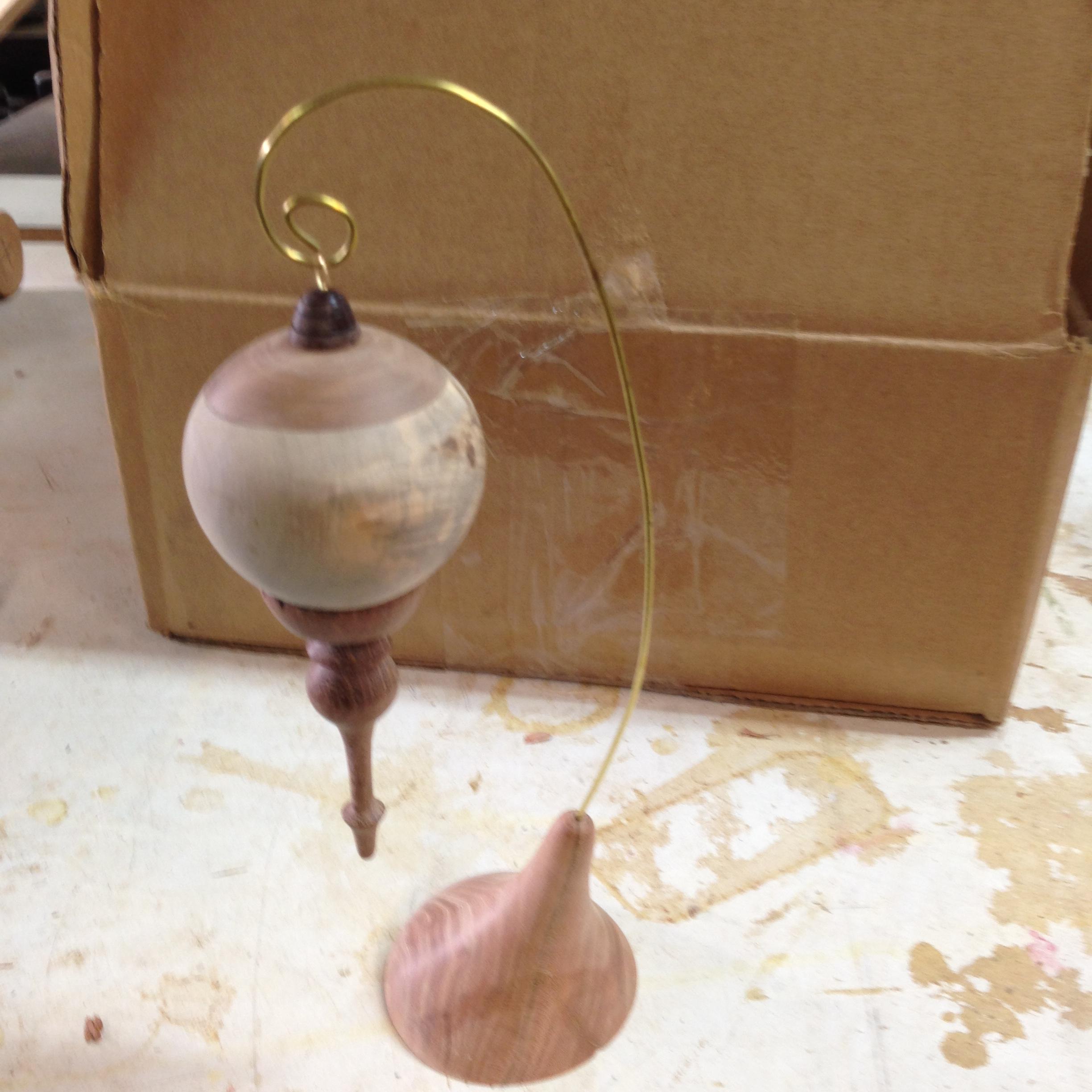

Saw this in American Woodturners and had to try it. It is really easy to do except bending the wire to get even curve.IMG_1122.thumb.JPG.9f101038722efd9a533f55721c1c2177.JPGIMG_1123.thumb.JPG.95b8e7b08489fbf92037827c8c38e476.JPG
You can cut at any angle you feel comfortable with , just be sure to sand farther down than the cut. You will have to hand sand the bottom. By the way drill for the wire before cut.

Is the brass wire a piece if brazing rod?
No it was a pack of 1/16 bar I got at Hobby Lobby, but any wire would work, just that smaller is easier to bend.

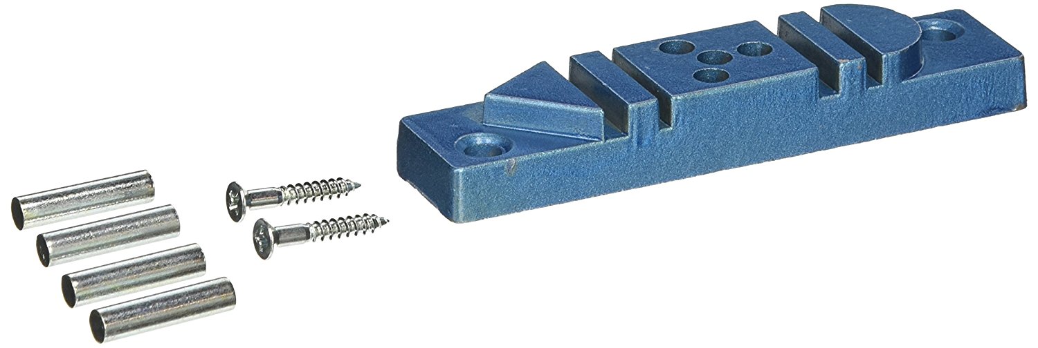

If you plan to do more of these in the future, you may want of consider one of these or similar to bend your wire. You probably could made one of your own too.
This is the Grizzly T10163 shown at Amazon...Hobby Lobby or Michael's likely carries a version also.
https://www.amazon.com/Grizzly-T10163-Wire-Bending-Jig/dp/B006SJE7N8
I have an antique of that ....meaning I have had it over 25 years.
