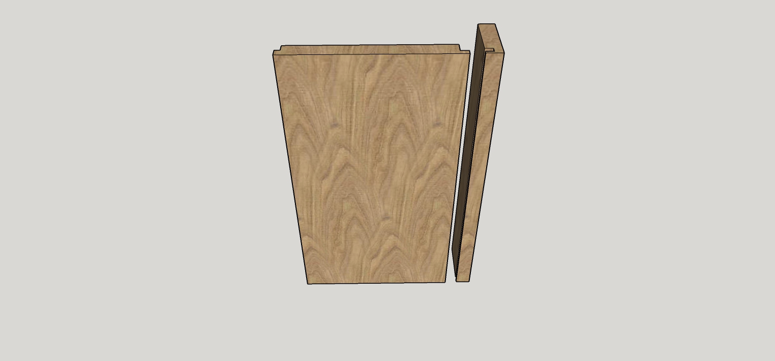

May 19, 20179 yr comment_109953 I think solid wood shouldn't be a problem. Side grain will run vertical meaning the primary expansion will be front to back. A separate face frame shouldn't restrict that movement. I'd fasten the face frame with a dado and tongue joint. A solid top with grain running left/right will expand in the same direction as the sides. I'd use wooden clips and an inside perimeter dado for the top to allow for any movement.You didn't say how you were making the doors. The plan you referenced has stick and cope overlay. Report

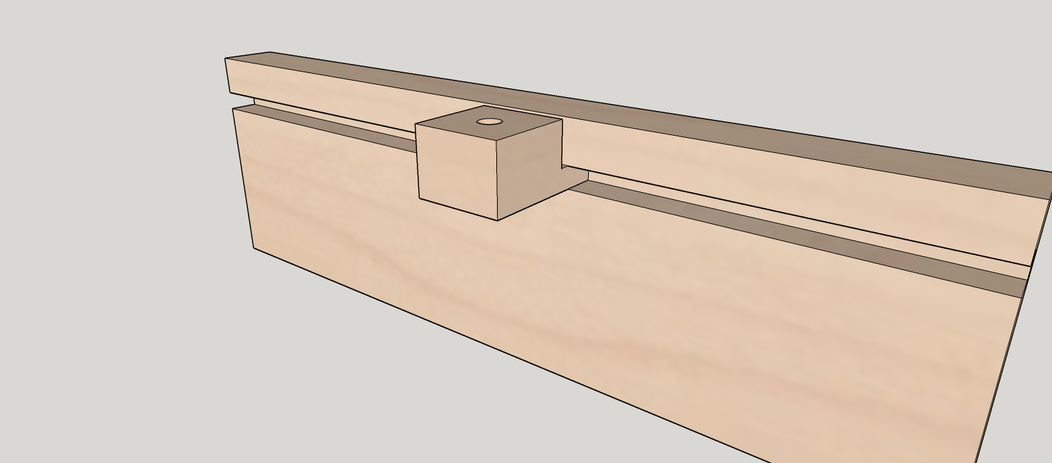

May 19, 20179 yr Author comment_109983 Thanks, would the face frame be glued into the dado and tongue joint? "I'd use wooden clips and an inside perimeter dado for the top to allow for any movement." The inside perimeter dado is understood. The wooden clips are not can you please explain further? The doors are cope and stick with a floating 1/4" T cherry flat panel. Inside the bin are laid on top a shallow full extension tray so that you open the doors fully and slide out the bin then remove the bin then empty the clothes then replace the bin. most hampers has good ventilation so I am considering having the back only come up 3/4 of the way. Report
May 19, 20179 yr comment_109987 16 minutes ago, Michael Thuman said: The wooden clips are not can you please explain further? Made these from 1" thick material the hole is slightly oversized for the screws I used. I would glue the sides to the face frame as the grain orientation is in the same direction. Here's a little drawing of the tongue and dado- not to scale! Again, these are just my ideas, hopefully others will give you some input. Report
