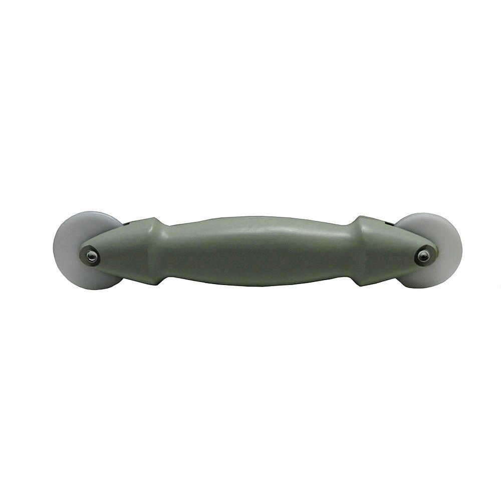

May 9, 20179 yr comment_108888 There's special roller http://www.homedepot.com/p/Screen-Spline-Plastic-Tool-654/205619545?cm_mmc=Shopping|THD|G|0|G-BASE-PLA-D25H-Hardware|&gclid=Cj0KEQjwrsDIBRDX3JCunOrr_YYBEiQAifH1Fm5fA4uEBDng3_-y5ojuQUhAI8WjpCP-G4PsxsbHhEQaAphi8P8HAQ&gclsrc=aw.ds Report

May 9, 20179 yr comment_108980 The double-ended roller tool has one wheel with a rounded profile to push the screen into the slot, then the other wheel, with a concave profile, pushes the spline into place. John Report

May 9, 20179 yr comment_108991 7 minutes ago, John Morris said: I don't know what this is. the instructions that came w/ the screen splining tool... RTM = Read The Manual... (sometimes also written as RTFM) Rescreening-Instructions.pdf selecting screen and spline.pdf The convex wheel is used to press the metal screen into the frame. The concave wheel is used to press the vinyl screen spline into place holding the screen to the frame. Using it is very easy, just make sure to use the correct end. To use the screen or spline installation tool, follow these easy steps: Using the concave wheel of the installation tool, seat the vinyl retainer spline into the channel by starting in a corner. Use short strokes going in the same direction. Try not to go back and forth. Use a small screwdriver to press the spline into the corners as necessary. As you press the spline into the frame it will make the screen taught. Once installed, trim the excess screen material with scissors or a utility knife. Report
