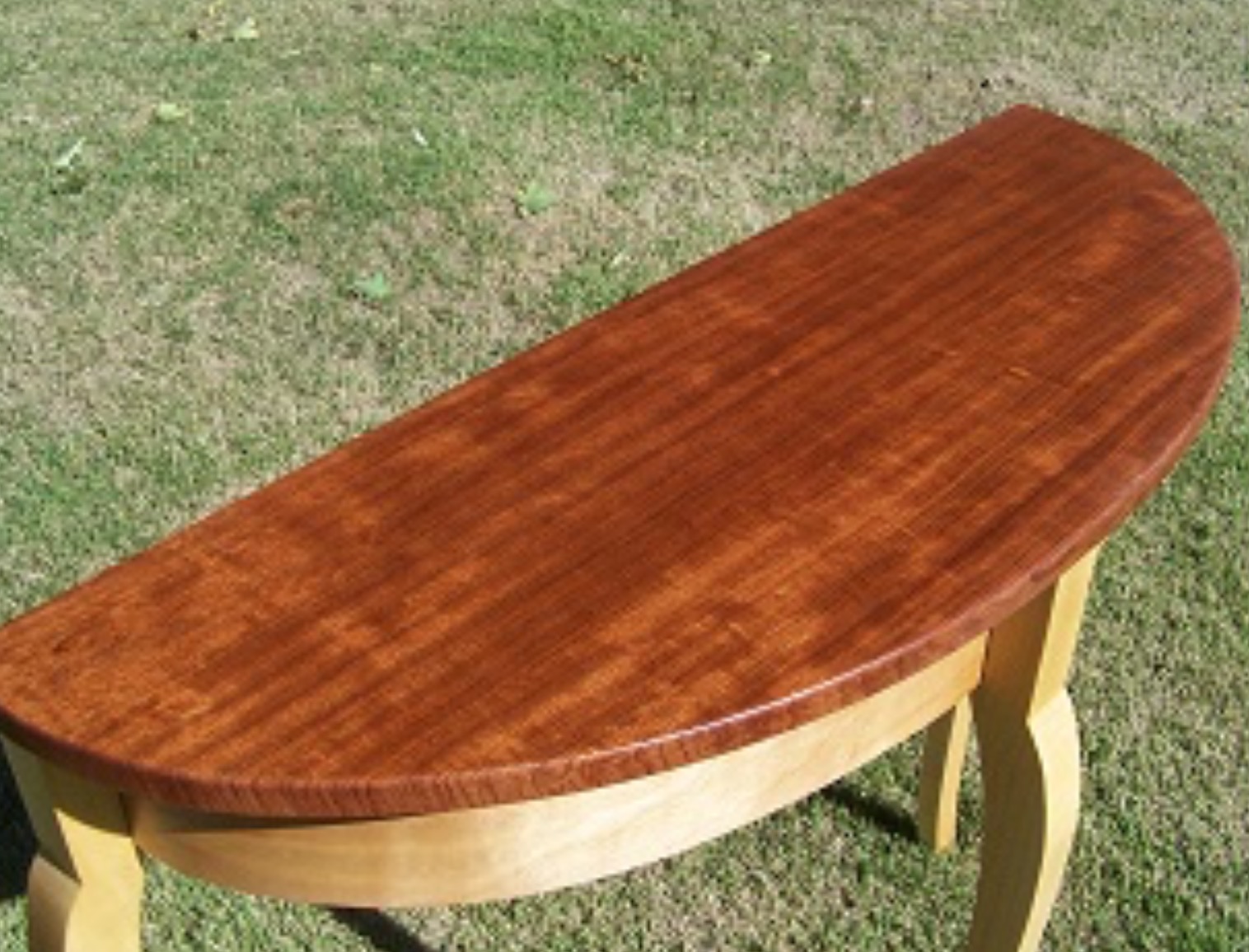

I will often apply a coat or two of shellac then put on the w/b finish.   It adds warmth and chatoyance   I say chatoyance makes the wood dance -- shimmer as you move viewing angle and depth of wood.   W/b alone, particularly if the mfr has not added anything to amber it, often appears cool and sometimes even a bit blue, particularly if the wood is natural and not stained.

That's a great explanation Keith. I knew I liked the look, but didn't really know what it was called.
Here is a Bubinga top I finished using Shellac and then a w/b finish on top.
