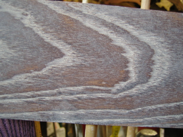

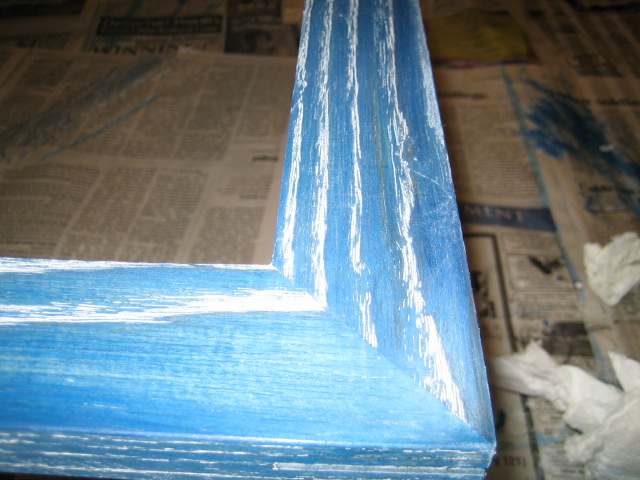

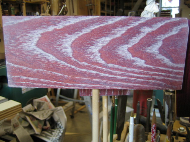

   When I did a white filler on mahogany or walnut I did the no-no in todays world for the best product for a really white filler I used White Lead...., I doubt if it is available anymore. It was a plumbing item.
  Oil base fillers use to come in any color.   But I doubt anyone here uses fillers much anymore so they might be hard to find.  I still have fillers sitting on the shelves for more than 50 years and they can still be thinned and used.
