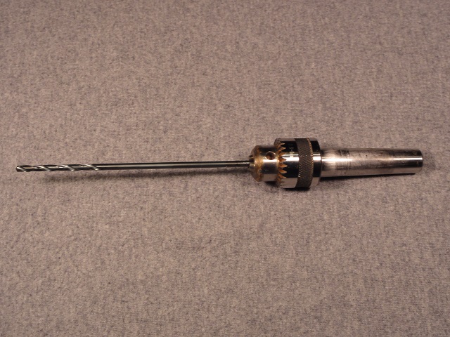

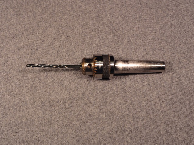

April 19, 20179 yr comment_106784 I found this drill chuck in some tools I bought at auction. It is really unique in that it has a 1/4" through hole. It can hold up to a 3/8" bit. What I like is the fact that when starting holes I can choke up on the bit and thus the bits will have less flex and drill accurate holes with less tendency to veer of track. Only problem is I cannot find where to purchase one to lead those who may want one. It has Daytona 0.6-6mm as the only markings on it.. A few pictures with a 1/8" bit 6" long. Report
April 19, 20179 yr comment_106793 That really would be handy for drilling on the lathe. Especially with smaller gauge bits that tend to bend. Report
April 20, 20179 yr comment_106845 Love it, specially the fact long bits can go through, that is convenient! Report
January 8, 20206 yr comment_214753 It's not so much the chuck but the arbor that makes it so special. Report
