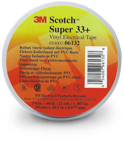

April 15, 20179 yr comment_106401 You can use a tape with less adhesive such as Scotch Double Sided tape but should keep the piece wrapped around the circumference in the areas you are not working. I use a good 3M electricians tape for the wrap. It can be stretched as it is applied. Report
