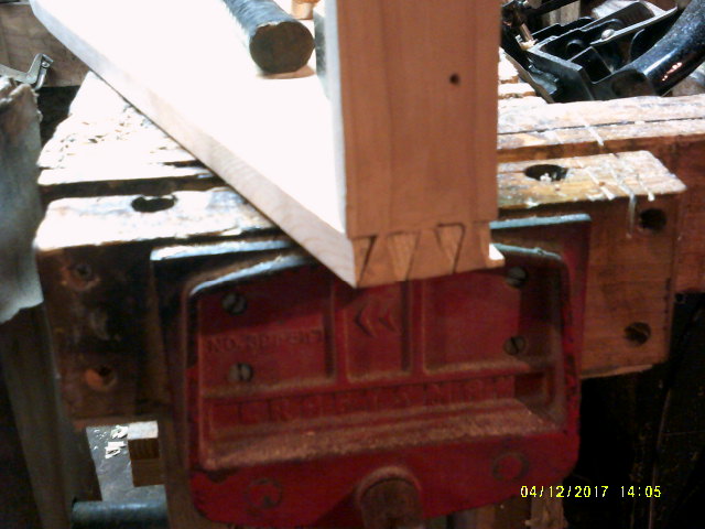

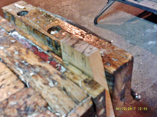

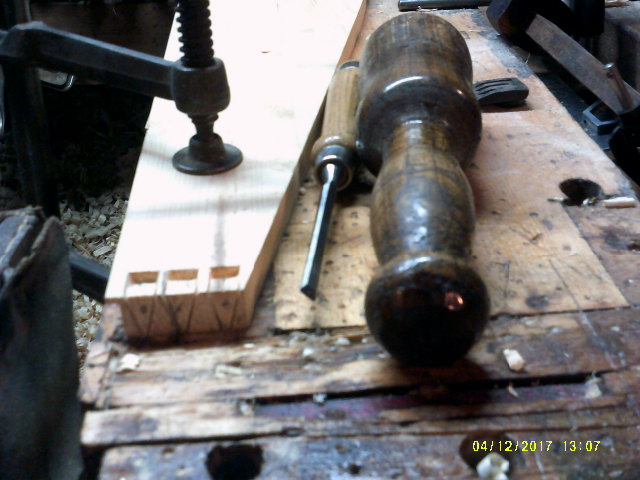

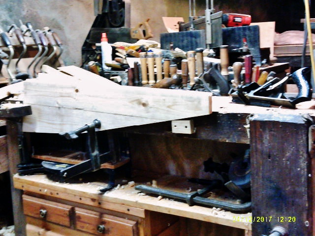

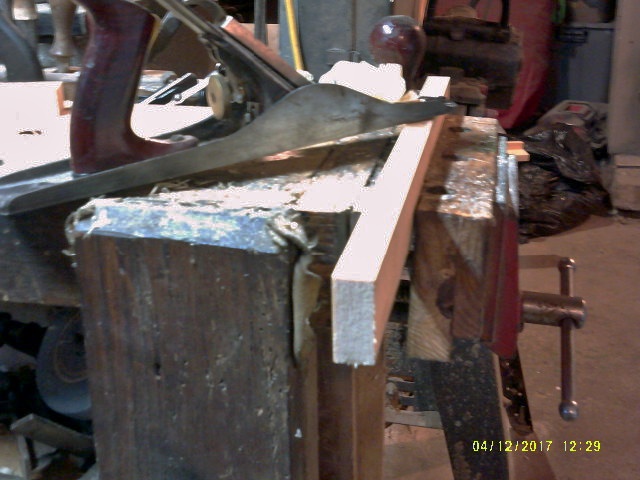

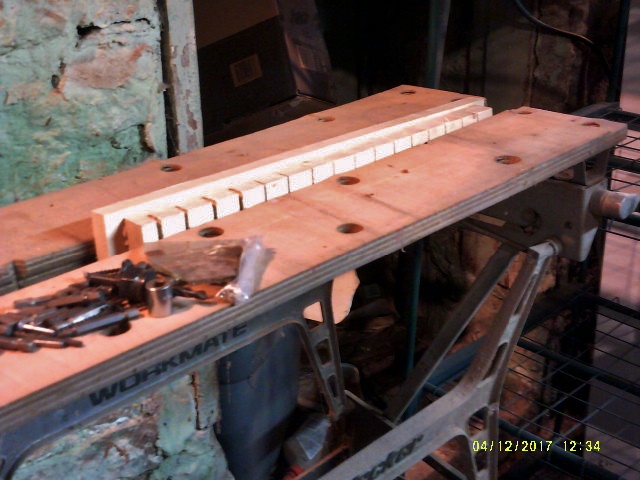

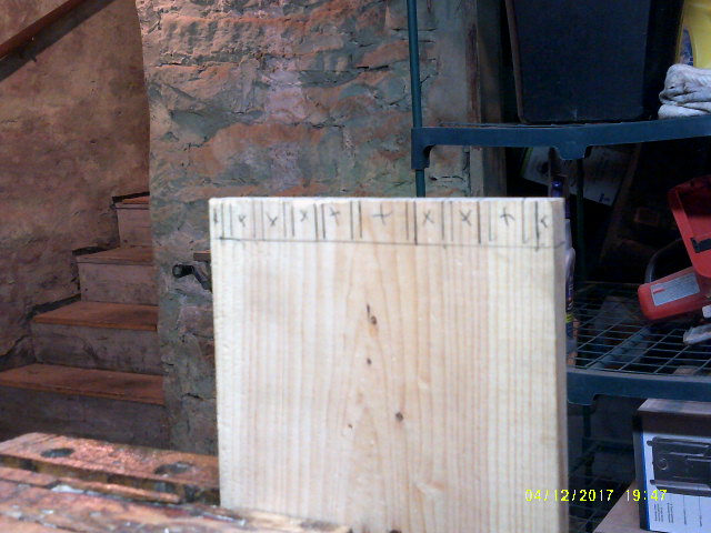

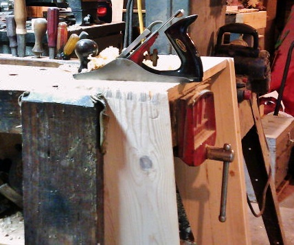

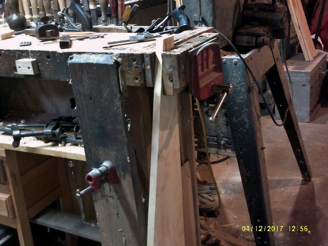

April 12, 20179 yr Author Popular Post comment_106094 Ok, scraps and some old cardboard boxes were toasted last night.... Got a late start today.....but.. Needed a place to add a back to the till. Depth is 1/4", width around...1/2" or so. One edge was easy to clamp up in the leg vise....the other was a little tricky.. I have a "hook" down on the end of the bench, called a Crochet. Stop block to uphold things, clamp to keep thing in their place. One of two resaws, this one will be behind the kerf block.. Slots to hold the saw's plates. Centered on the resawn part, but..hold to glue and clamp this thing? WorkMate! Works for me. Got out the usual suspects.. Laid out for some dovetail pins, and ran the "dovetail" saw a bit. Not a whole lot of leg room.. Got some lines to cut to.. Well abused spot.... Then some chopping toys.. Chop a bit from this side, leaving a little out on the ends, then Flip it over, and chop out the waste. Had to use a skinny chisel for this side.....somehow, got both of the tops done.. Sitting with the "inside" faces together. Found out, I had run a rebate on the wrong edge of the piece for across the top....trim a new board to length, surface S4S with a couple jack planes Whew, and sweeping the floor between each step.. Laid out the tails, and cut them out.....test fit? Meh...will need a little tune up, but At least it is square. I got the other end done, as well....dang knot was in the way.....will need a bit of dust & glue filler. Set these three parts aside, swept the floor ...again. Decided to call it an afternoon. No A/C in the shop, I'm soaked clear through, and tired. BREAKTIME! Maybe later tonight, I might wander back to the shop.....Hmmm, 3 hours be enough for one day's work? Stay tuned... Report

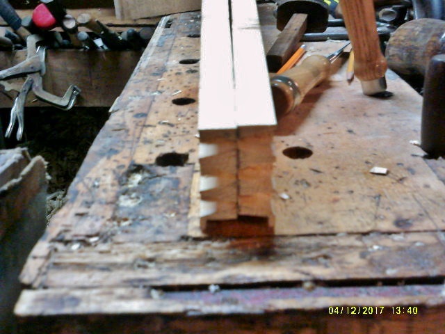

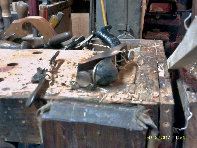

April 13, 20179 yr Author Popular Post comment_106151 Snuck back down to the shop....figured when the Mountain Dew ran out, I would call it a day/night/whatever Wider board, means more dovetails to do. These will be pins first this time around. Idea is to do the pins on both ends of the bottom board...saw a little.. Yep, that was the chisel for this side. leaving a little bit out on the end, to support things when I flip the board over.. Needed a skinny chisel for this side, wound up using quite a few chisels.. And a few wider ones. Got the pins done, time to lay out the tails. Cheated a bit.. Sharpened the pencil and traced around ALL of the pins, while letting the assembly hold things almost still....Refined the lines, bandsaw to cut on the waste side of the lines, trying to leave the lines. More chisel work...test fits....then got the glue up out of the Work Mate. Test fit showed it needed a sliver cut off. Got that done, and set the til parts in their places.... Set two saws in there, to see how the will fit....The blade holder is just sitting there loose, haven't got it installed....yet. Also need to see how the handle rest will fit....don't think the saws will just sit like this.. This way, I can lean a saw out at the top, and lift the saw up. May get to spread some Elmers by the weekend.....if I get a wee bit of time...Stay tuned. Report

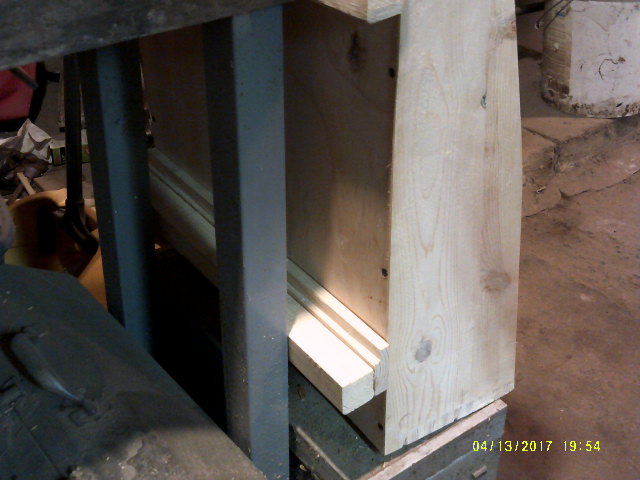

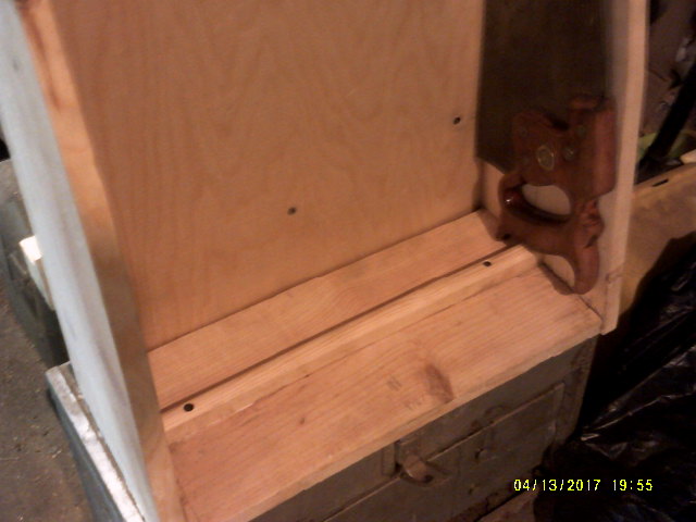

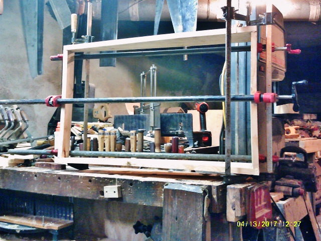

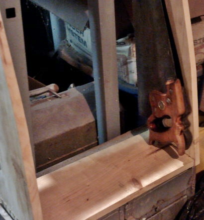

April 13, 20179 yr Author Popular Post comment_106220 Test fit the handle rest today...meh, too low. Made a new one a wee bit taller. Then came the matter of rounding over this..thing.. Don't think the handles would like sitting on this, grabbed a couple toys.. Low angle block plane, and a spokeshave....then finished up with a bit of sandpaper... Handles might like this better. Test fit... Seemed to be about right. Decided to glue the carcass up, to make fitting other parts a bit better.. Sizes can change, when dovetails are pulled tight. letting Elmer do his thing for a while. Maybe later, I can start on other parts. Lower cleat to stand the bottom of the til away from the bench legs, is now in the Work Mate clamp. Rest of the day off? We'll see..... Report

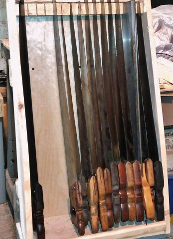

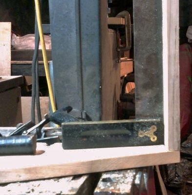

April 14, 20179 yr Author Popular Post comment_106240 Out of the clamps...planed and sanded the dovetailed corners... Cut the back to fit, added the saw keeper at the top, after A few cuts were made. Those screws are to attach the til to the cleats holding it up.. Will add a bit more to this one, still not enough lean back..... After all that work to make that little rest,,this was the ONLY saw it worked with. Removed it, pending a few changes going on.... Got the saws into the til...barely.. Added a keeper bar after this shot, couple saw didn't want to stay put. used the keeper bar to store two shorty panel saws. Have one more regular length saw, when it gets back from the sharpener's place. Will add more lean back, and try again on the handle rest,,tomorrow, maybe. May add a topper, as I had to daylight things to get the longer saws in. I am bushed.....stay tuned.. Report

April 14, 20179 yr Author Popular Post comment_106323 Saw Til PIP #2: Floor Show. Where the til USED to be.. . Then look up a bit...the two saws to the left? I added a peg for the short saws to sit on. Each handle sits in a notch on the 7/8" dowel. Open slot for the missing saw. May get it back tomorrow? Side view. Keyhole saw has a smaller peg to hold onto... "Horns" on the handles sit in a groove, made with two 1 x1s Have since added a small peg, for my "dovetail saw" to hang from. Sits above the short saws on the outside. and a kerf to hold the blade was cut into the block holding the Large peg. No Finish on this....yet. BTW: That Junker lathe, it has supplied a belt for the sanding machine. Test drive showed the belt will stay put. Parting out the rest of the lathe....mostly into a trash can. Other than the parts a friend requested, that is. Mountain Dew can is empty, time to stop for today.....Not sure IF this will get posted as a"Project" Report
