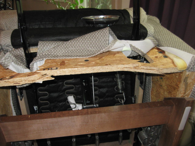

April 12, 20179 yr Author comment_106069 On 4/6/2017 at 9:40 PM, Gerald said: I have a Lane or Lazy Boy mission style with broke foot rest mech (clean in two by my grandson) .Where can I get a replacement and any idea how much? Sorry, I just saw this. La-z-boy used to have a lifetime warranty on mechs. A lot of the other mechs are OEM by Leggett & Platt or Omega-Motion. I can give you contacts for any of these if you can identify the actual mfr (look for a tag on the footrest's arm). I've had to buy L&P and Omega-Motion will repair or replace if you pay both ways shipping. If you ever work on La-z-boy, be sure to have Torx drivers. They're about the only one that uses them, and they use them in most parts. Here is a better look at that OSB panel mid-replacement Report
