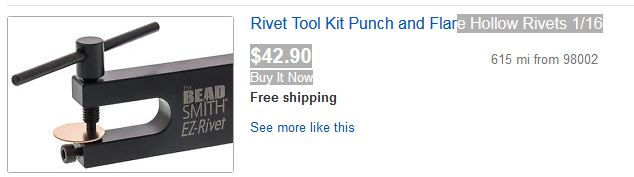

April 29, 20179 yr comment_107745 My guess is a Hollow Rivet flaring tool for leather . Herb Edited April 29, 20179 yr by Dadio Report
