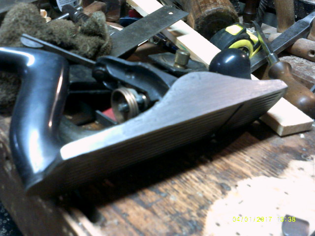

Japanning is black, BTW...Sole?
From what I can see the Japanning is in very good condition??? The rest turned out pretty nice...Looked like is "drove" pretty well too.

On 4/1/2017 at 9:01 PM, steven newman said:
After some "research" found some info about these two planes...
Stanley had a Model number of G12-004.    Made in England.    It is a #4c type of plane.   While the handles are a dark brown plastic, the bolts for them have a brass nut.
Millers Falls No. 9 is a type 4...1955 era plane..  Has a smooth sole.  and some very fancy handles.

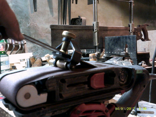

Iron works ( and my hands were smelling like a Foundry..)  The iron needed it's back flattened a bit, sat too long clamped up.   Held the iron flat along the side of the beltsander
That jig is aVeritas MK1 honing guide.   Used it and the sander..
Held for the camera....When the beltsander is running, I have both hands on the guide, with a couple fingertips near the iron's edge.   When the fingertips say they are too warm, I dunk the iron in that cup of water.    I go until I have a nice bevel.   Then the sander is a benchtop, as I will set oilstones and  wet-or-dry sandpaper ON the belt.   That way, they don't slide around.  Got up to 2000 grit, both the 25 degree bevel and the back.  I was going to use the strop...forgot, oops.
Once the woodworking for the day was done, I set up a pine 2x4 in the vise for a test drive....took a few tries to get the settings just  right.   I can read a paper through those shavings sitting there.   It willjust have to do, for now.
