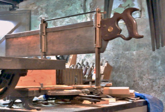

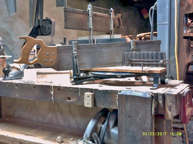

Saws that came back today..
The 4' x 24"  "Small" size saw.  and.
the 5" x 28" large saw.     This is the"other" of the two big mitre saws.  and is the older of the two saws...pre-1928
Both were made by Disston, the smaller saw was after HK Porter bought out Disston.   About the same time that Stanley #2246 Mitre Box was made.
